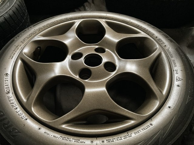

I’ve had a set of messed up wheels that weren’t worth powder coating, so I painted them with rattle can and it came out great and was plenty durable. As long as proper prep work is done, you‘re patient with the application, and you allow the paint to cure enough before mounting tires, the paint should be plenty durable once fully cured. Mine stood up to crushing cones at auto-x and a good amount of highway miles and gravel roads only requiring a few touchup spots.
It’s certainly not as durable as powder coating, but it’s definitely a worthy alternative if you’re looking to save costs.

I’ve had a set of messed up wheels that weren’t worth powder coating, and I painted them with rattle can and it came out great and was plenty durable. As long as proper prep work is done, and you allow the paint to cure enough before mounting tires, the paint should be plenty durable once fully cured. Mine stood up to crushing cones at auto-x and a good amount of highway miles and gravel roads only requiring a few touchup spots View attachment 38548
Oh wow, those look boss mate!

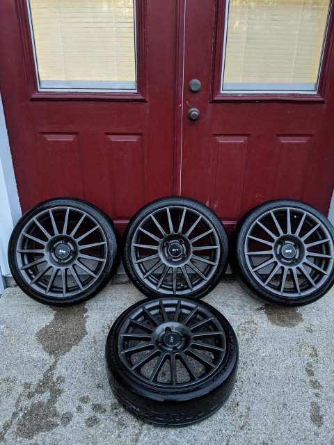

I just gave my old SEL wheels a rattle can paint job and I’m very happy with the results. These are my winter wheels.
Those look boss mate! What colour is that if you dont mind me asking
