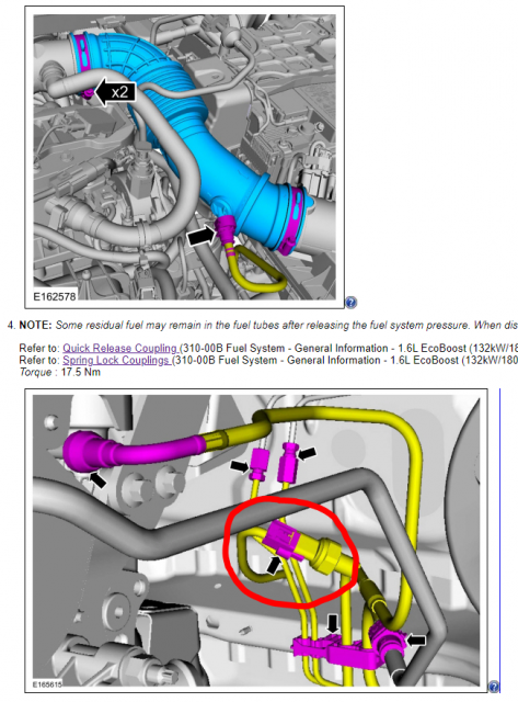

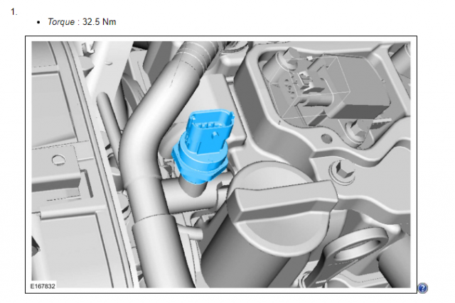

Sounds like a bad lowside fuel pressure sensor
just monitor low side fuel pressure and high side fuel pressure for a couple of days and see if anything is out of the ordinary
hpfp pressure at idle is around 600-700psi
low side is around 60-70ish psi
When you give it the beams, hpfp can go up to 2900ish psi and low side can go up to 100ish
both readings shall go up and down in a predictable manner, If you see any spikes or numbers being still, is a sign that that sensor is going bad
https://www.rockauto.com/en/catalog...uel+&+air,fuel+injection+pressure+sensor,6376
CM5250 = low side sensor
CM5225 = high pressure sensor
high side sensor location:
low side sensor location

Thank you for the detailed response. The lowside FP sensor ended up fixing it!
