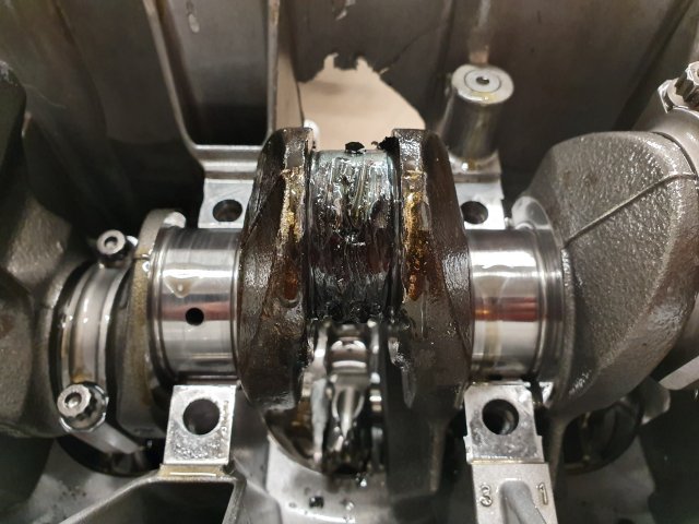

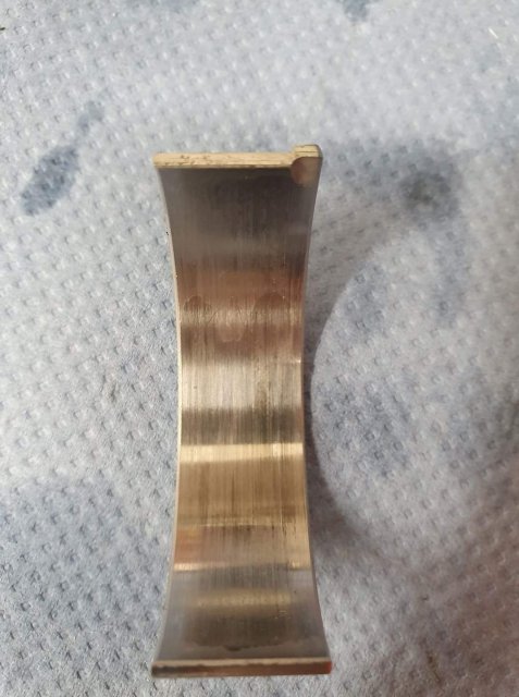

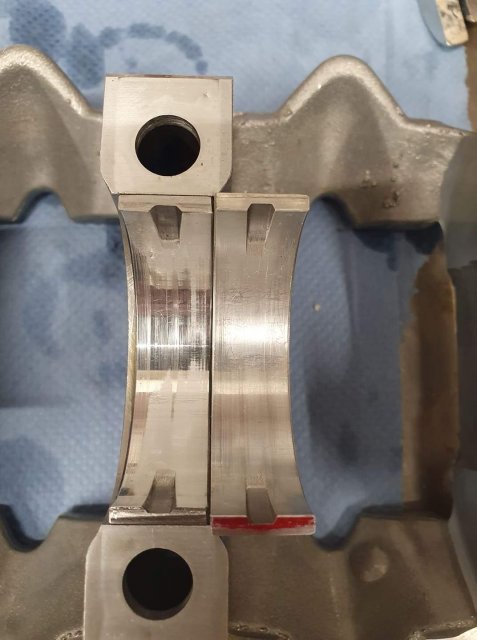

We have not honed at temperature, but we do have comparisons from different cylinder walls now, and the deck plate honed at ambient seems to work. But of course it would be best to have all bases covered.

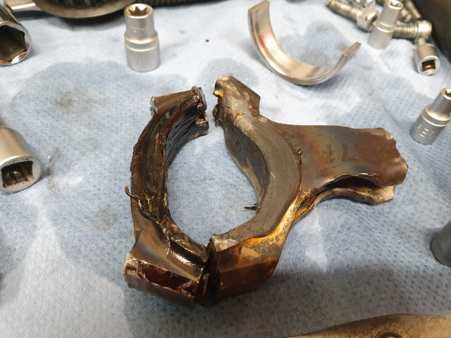

Here is a Mahle rod end bearing and a comparison between mains from the stock engine vs the failing one:
Rod ends on that particular engine failed with all oils we tried.
The last engine that was working well from the rod bearings side, we used Motul 300V 5W40 with Bardahl Full Metal additive. We changed oil after each 80 SSkm.
How does the logic work in case of the oil being a cause for knock??
Thanks for the photos @eq5
Let me start by saying I'm no bearing or combustion expert at all, but I can ask around at the office and see if some of our team would lend their personal opinion, if you're soliciting the help of strangers on the internet lol
One possible cause for polishing like that can be micro-abrasion from particles in the oil. I'm not familiar with the composition of race oils with "full metal additives", but I'll do some homework.
If you only saw this one cylinder though, that theory might go out the window.
And perhaps I should preface that my statement about knock and oil is related to TGDI engines... if you switched to TBI, this may no longer be a factor for you.
Turbocharged, Gasoline, Direct Injected engines are extremely sensitive to oil composition. Some quantity of oil obviously gets into the combustion chamber (either by blow by, PCV circuits, leaks from the turbocharger, etc.), and that oil presence leads to situations like "mega knock" or "super knock". I don't know enough on the topic to know if it's related to the combustibility of the oil, or how perhaps different elements of the oil effect the combustion process and induce pre-ignition. I simply don't know. But if you think this may be a factor, I can ask some experts who have been working closely on this issue for many years.
I know many recent TDGI engines must specifically run SN Plus oils (as stated in their respective owners manuals), in order to prevent "super knock" scenarios which can lead to catastrophic engine failure like you are seeing. Obviously the first evidence of knock is usually broken ring lands, but I have also seen bent rods quite often. Valve damage and block damage is usually secondary.
I know that when these super knock events occur, they are usually in one cylinder. When you get the engine back together, perhaps add knock signal to something you're logging, and maybe something to have your dyno guys look very closely at.

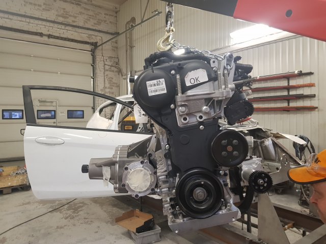

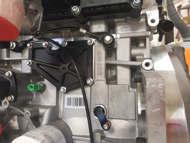

We run the original GDI supported by 4 port injectors. Our knock issue could be identified from the rings in all cylinders, just that one piston managed to burn through before the others. With these symptoms occuring in all cylinders, could I cross out the possibility of something working against us in the oil we use?
Knock is monitored through 2 knock sensors and ECU makes corrections based on the knock events.
Will assemble the engine next week. Checked/cleaned the 4+4 injectors, tested the fuel in a lab, will build the map from zero to avoid any unwanted corrections in the ECU calibrations. Hopefully these will lead to a reliable end result. Surely want to cover as many bases as possible, such as the possibilty of using a wrong oil.

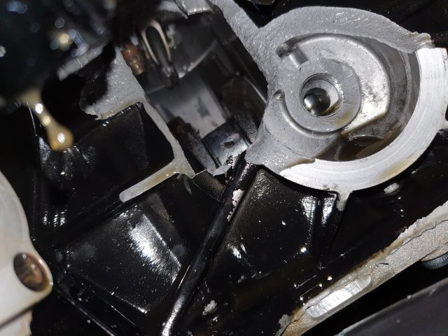

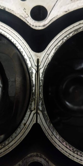

I see what you did there through the hole in the block pic...very clever. HAHA. How Did anyone not see that is beyond me!
God damn it, my wife bought one of those bottle openers in Costa Rica. I never knew it was a block hole sizing tool.
I guess she DOES love me after all.

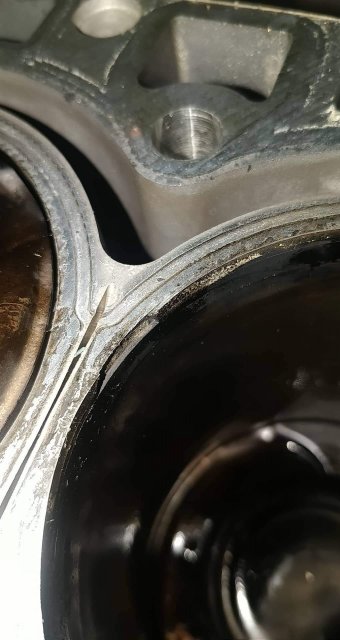

Sorry guys, been really busy here to post latest updates. But there are some good news finally...after blowing a head gasket in dyno, the last version of the engine has been holding now.
For some reason the 1mm Athena racing head gaskets have failed us twice now, even before we got to proper stages. Both times it occured when we got some more heat into the engine, gasket started leaking between the cylinders. So after the last failure, as I could not run the original gasket of 0,5mm due to piston-to-head clearance, we digged into what else Ford has to offer. Turns out they found 0,7mm and 0,9mm gaskets for us. Though those bastards look exactly the same and are just a little bit thicker than the 0,5mm ones, they are priced about 12 times higher. :censored:
So now finally we got the car running properly and it is an awesome machine. Obviously it is unreasonable to expect us to match the world champion in his WRC, but all the R5 cars had to bite the dust :cool:. Results here: https://www.ewrc-results.com/final/61496-grossi-toidukaubad-viru-rally-2020/
We are running quite safe on the mapping, as reliability is of highest priority now. We will run it in this setup for some time to make sure we have a good baseline for a reliable solution. If everything works, then we might crank up the boost at some point and look for some extra power.
