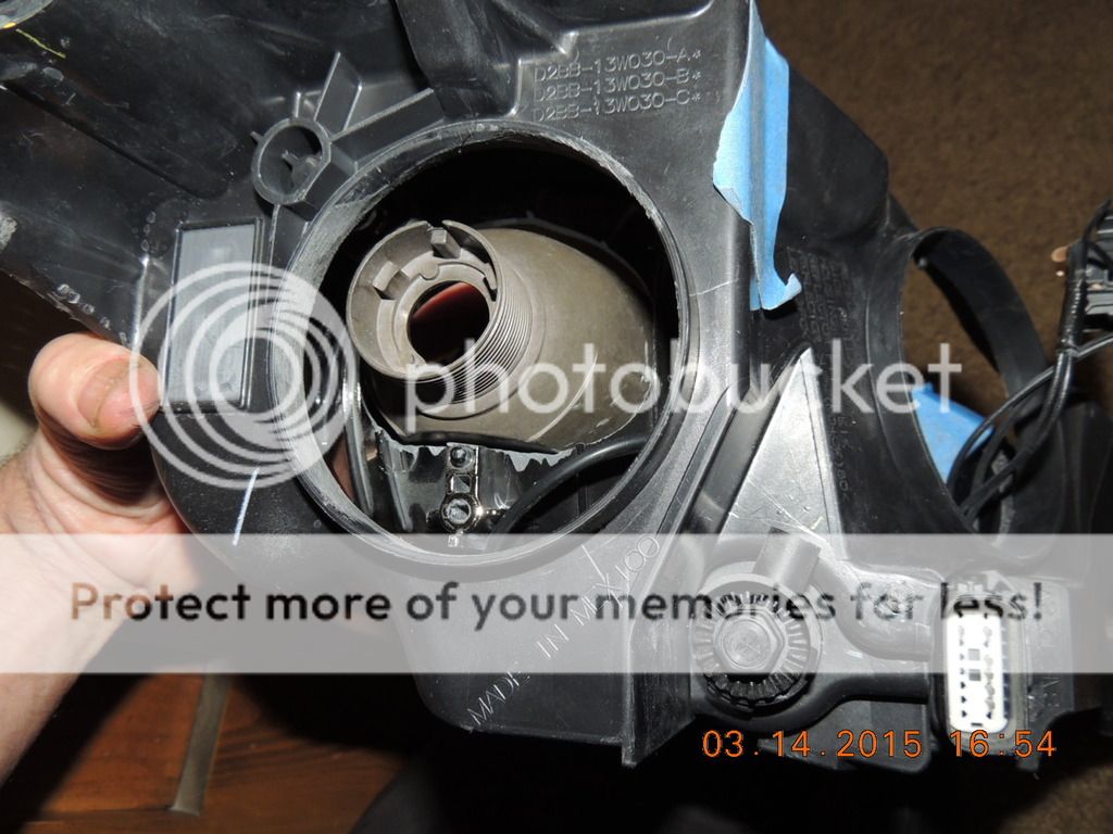

I bought a set of the Mini H1 to use in the car and the DS2 in the truck but decided to go all out and put in the bigger and better DS2 system in the car and will order another one for the truck, I guess I better put up an ad for the Minis....

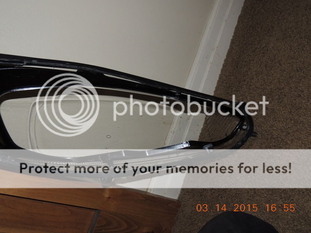

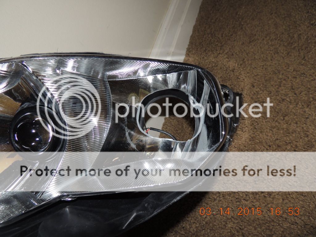

This is taking some serious effort as a far tighter fit than the pics will show, had to recess the projectors a lot to get coverage with the shields which are also going to take a lot of trimming to make work.

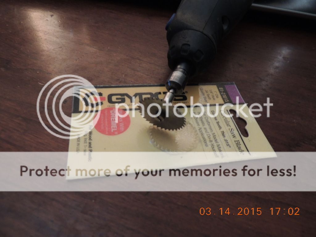

#1, getting the lights apart is a pain in the arse with the adhesive Ford uses. I tested different methods, diamond cut off wheel, heat gun, combination and in the end the job would look like crap and take a great deal of effort.
This and how I used it save a huge amount of effort, it was a $17 demel saw blade and cuts, when used right, without melting the ABS back together.
I decided to cut out the backing and not even mess with the adhesive, I will use proper adhesive to glue them back together and then with the valley nearly all the way around will use black silicone sealer and make a really clean coved seal over it all, it will come out quite nice, pics will be posted when I get to that part.
I "cheated" a bit on the corner, no need to cut it out, will not show when done, left it a bit stronger that way....
First job is always the one that takes most of the time, that hole took a couple of hours to carefully make it just right, the second light will take 25% of the time at the most.

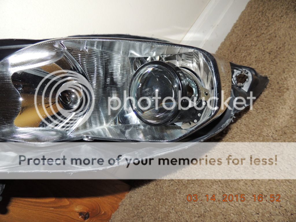

High beam replaced with Mirimoto 25mm DRL LED, they are VERY bright and look better than the picture shows, aluminum housing, etc......

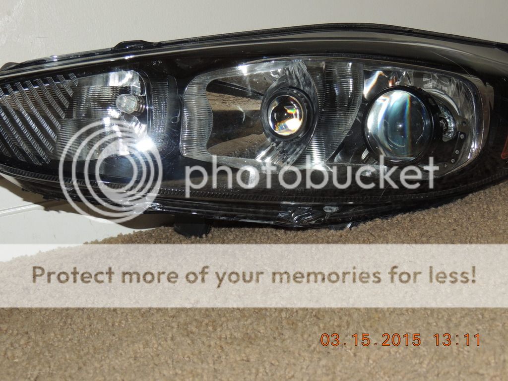

35mm wide angle shot, the projector is a much bigger that the picture makes it look.

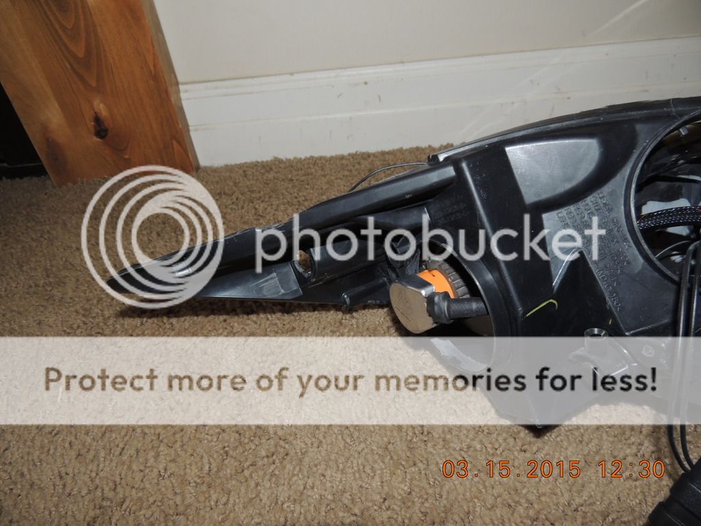

Rear view, I used a sanding drum for most of the holes and to remove the stock inner lip on this area so I could have more room for the back of the projector, adjusting them, installing bulbs, etc.....

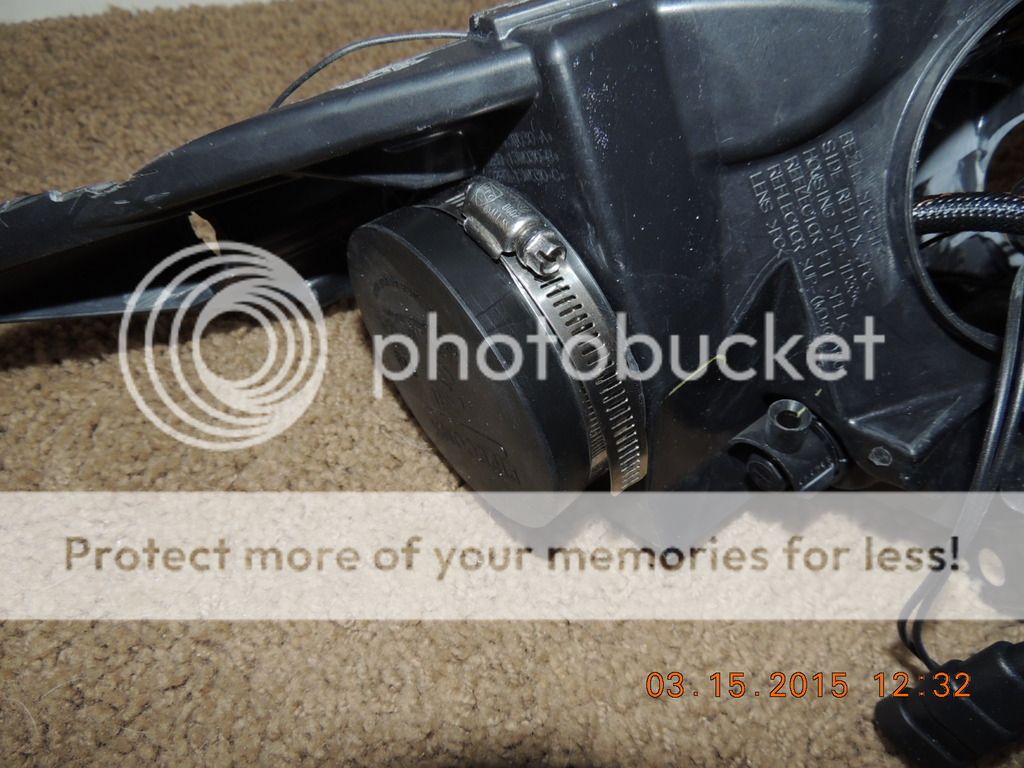

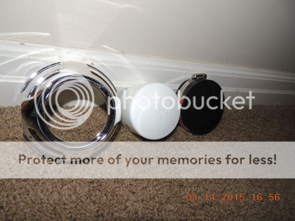

I went to get some 3" black ABS caps but they were out and only had one PVC one, not a big deal as will be inside the lights, this will be used between the lock nuts and stock housing to hold the projector in place and allow some swiveling to adjust properly. Lots of fine trimming will be required, hole in the middle, etc. I could just screw the projector to the housing via 4 holes on the flange but then not adjustable easily.
PVC cap in the middle, on the right side is a rubber 3" ABS cap, it will be secured with a hose clamp and allow access to adjust the angles and or change bulbs if ever needed. This is going to take some trimming and some work on the frame rails, reshaped a bit, big hammer time, that part is done.

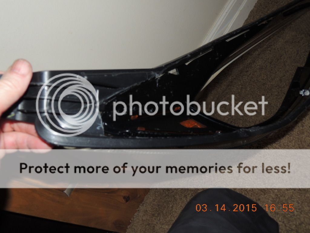

Those are the smallest but huge shields on the left, I had to recess the projectors a great deal so they will fit and they will take a lot of time to fit just right.

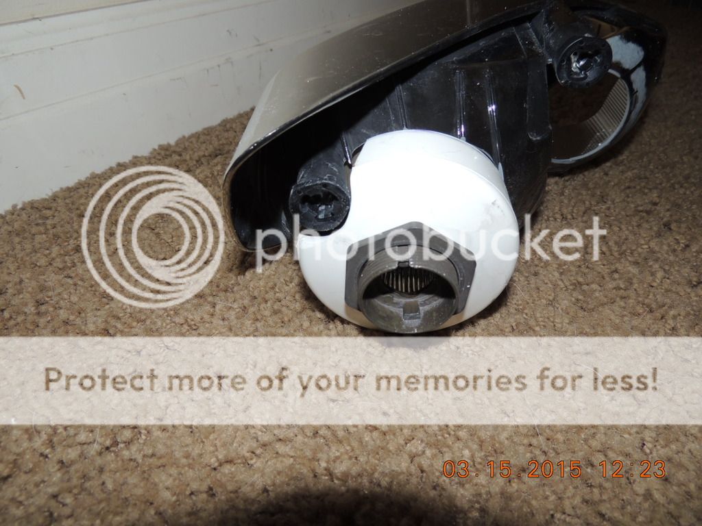

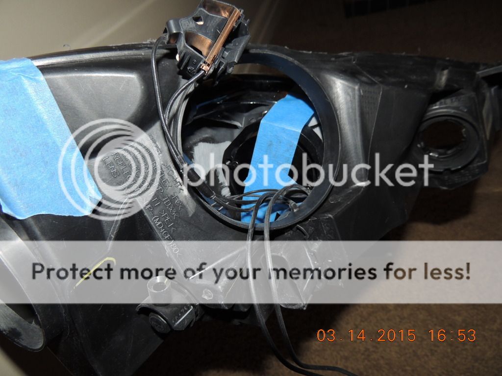

PVC rear mounting cup so allow for alignment and solid lock down of the projectors, a fair amount of time getting this just right. I will add some beads of silicone after aligned to ensure they do not come loose.
Option on running connector to ballast, 1st is easier initially but requires removing ballast to take out the lights, which I have done a couple of dozen times so far. It also results in less choice of where to mount the ballasts, higher and more forward but very easy to seal.
This way is better for ballast mounting and headlight removal but harder to seal though I have a good idea I will look into.
3" pipe seal from hardware store, fits, seals, easy install, clears everything(with a slight tweak on the frame rails with a big rubber hammer but no worries on that) If I wind a curl into the wiring it would be easier to use the rubber grommet on the ballast harness, the idea I had above, I think this will work best.
How they look together for now, no shroud on the projectors yet though and the parking/turn bulb is not in straight.
