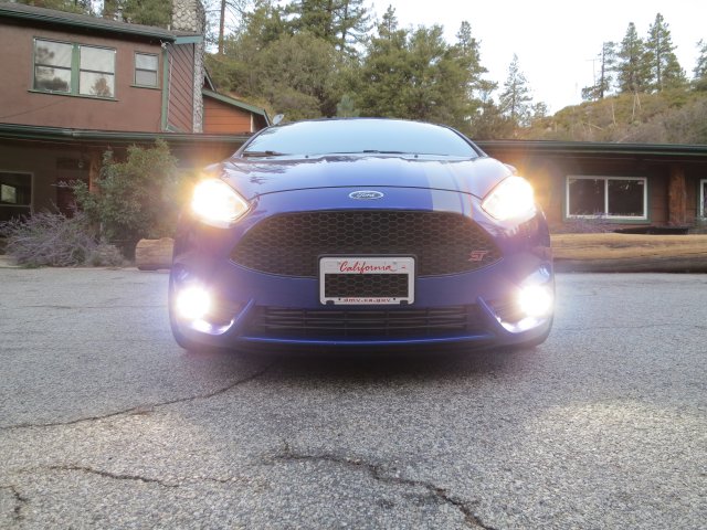

If it's better auxiliary lighting you want, swap factory fogs to Baja Designs Squadron Sport (or heaven forbid, Squadron Pro) with combo-driving-lens and you'll have plenty of light. BD SquadSport.jpg

If it's better auxiliary lighting you want, swap factory fogs to Baja Designs Squadron Sport (or heaven forbid, Squadron Pro) with combo-driving-lens and you'll have plenty of light. View attachment 44273
How easy were they to install? Are they plug and play with the stock fog light wiring and mounting points? I've been thinking about getting those, they look really bright.
The BD Rally Innovations Fog Pocket Kit (for Ford/Subaru) comes with Ford wiring adaptors, so install was simple. Factory bumper mount has default outward angle that points lights to out. You may not notice if you run the amber wide-lens that comes with the kit, but I swapped to combo-driving lens. I added 1/4" nylon spacers to inside holes between mounting plate and bumper to point lights forward.
Thanks! I want to pick up a set of those at some point.
