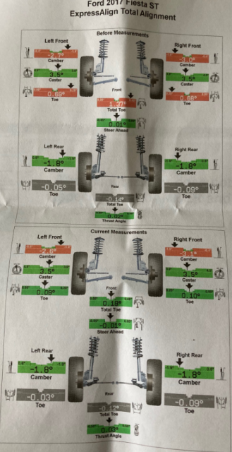

#8934
404
575
Lots!
This was camber bolts + slotted holes pushed all the way on the FA 500s+ everything I could dial in up top with the standard holes in the strut tower.
edit: also depro rear camber plates
