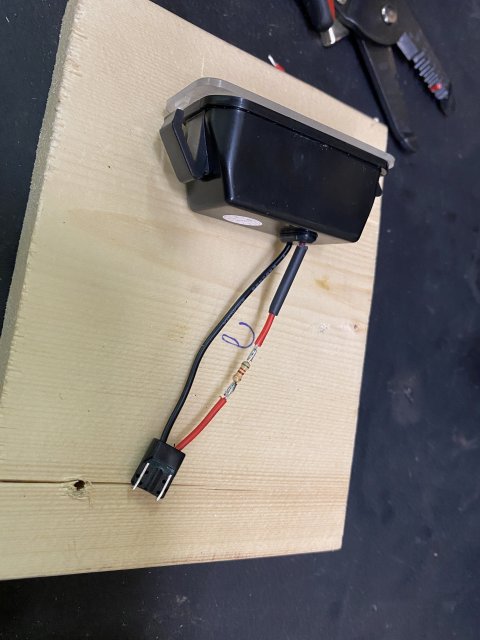

Let me start by saying I am an idiot when it comes to electrical circuits and I have no idea if what I did is going to cause issues. But I wanted LED license plate bulbs really bad and I can be a little picky about the color and brightness of my bulbs.
First I installed standard 194 LED bulbs into the factory housings. I was disappointed because one bulb was facing the plate and the other was facing off to the side. So I went back to stock bulbs and started looking for other options. I finally came across an LED setup that replaces the whole housing rather than just the bulb and decided to give them a try. I knew they were going to be way too bright (who uses 18 LEDs for a license plate light?!) but I figured I could work with them. I did some bench testing and found that a 500ohm resistor got me the brightness I was looking for (EDIT: originally I used 1/4W resistors but I'm changing to 1/2W resistors just to be safe). I also left the lights hooked up to 12v on my work bench for a while to make sure nothing was going to overheat. The resistor didn't heat up at all so I figured I was good and soldered them into the lights. So far it's been working fine but it's only been a day. I'm hoping I don't cause any issues with the canbus system.

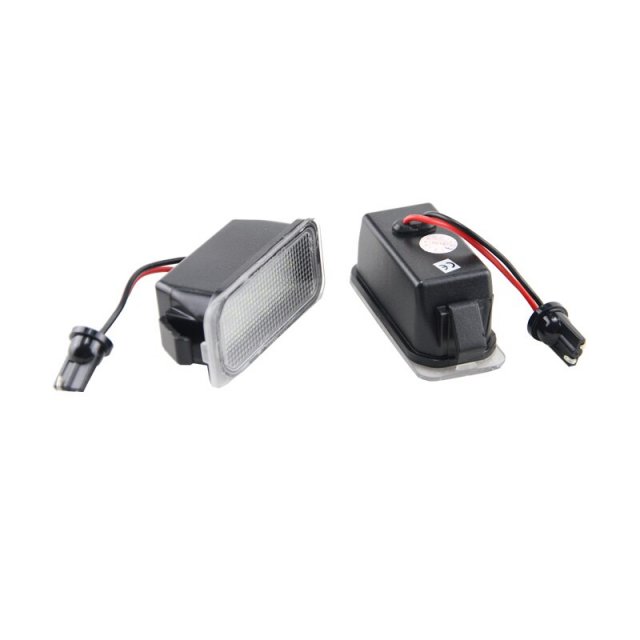

These are the lights I got:
https://www.aliexpress.com/item/4000287930307.html

And this is how I modified them with a 500ohm 1/4W resistor:

Just added a link to the post. I got mine from aliexpress but you can find similar pieces on Amazon, eBay, etc.
I'm learning that the 1/4W resistors I used may be too small. I will be replacing them with 1/2W resistors and that should be plenty.

They use the same type of spring clip as OEM. They fit a little tight so taking them out is tough but overall the fit is good.
The resistors can be purchased individually from electronics suppliers like Mouser or Digikey.
I ordered some more resistors to test, I think a slightly lower ohm would be better but I didn't have anything between 100 and 500. I'll test those in a couple days and report back here.
