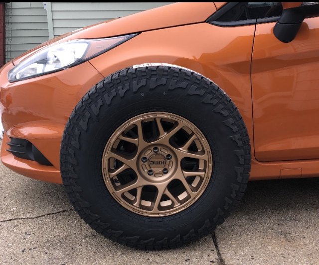

Lmao I wish you luck...... here is a 235/75r15 I put on my wife’s crosstrek with a 2 inch lift last month. I put in front of my st as thought was funny how huge they are. No fn way gonna get it under fender. I have a headache from trying to get to fit under the crosstrek and it still rubs some after cutting smit out of stuff and pounding on pinch weld etc.

Oh and fiesta in pic is at stock ride height.......Again good luck lmao

Looks like cutting away was the right idea haha
