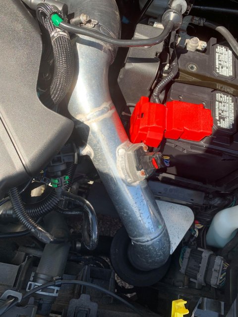

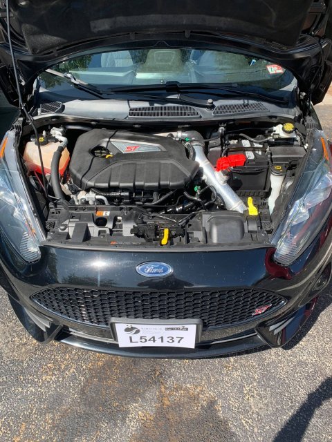

It has two areas where it gets cold air. The stock "ram air" section and the lower area that ends up near the cold side boost hose. It's been on my car for around 80k miles now and I haven't had a single issue. I have a pic from the top, but not the bottom.

That is helpful, does this intake need any of the stock components of the intake? I dont have any of the stock intake.

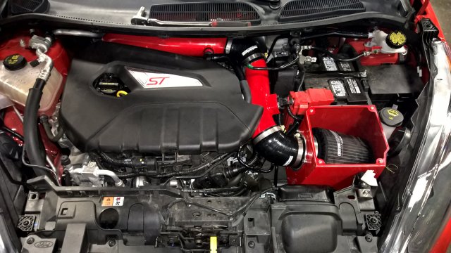

Just buy an ST200 box and stuff a filter of your choice....stock or high flow filter...there has been no difference in one over the other* just my 2 cents

Absolutely agree. ST200 air box and call it a day.
If you don't have any of the stock intake though it's not going to work.

My suggestion * Would be buy a Whoosh or Ram Air crossover tube and intake hose and ST200 airbox. Just food for thought!
