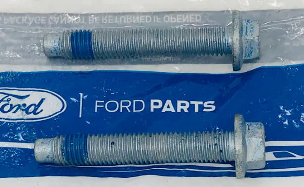

I’m attempting to install the whoosh 2 point trac bar. I ordered the replacement LCA stretch bolts off of Ford parts. I don’t think they are the right size.
The ones I ordered are 15mm and the stock ones on the car are 18mm.
Does anyone have a part number for these?
Here’s a pic of the ones I ordered
The bag came with 4 bolts.

Use a corded impact. It makes a huge difference. The ones I order from whoosh are always 18mm bolts. Not sure how yours are 15mm. Have you tried contacting ford about this?

Yeah just checked the entire parts list for the subframe. You ordered the correct bolt this must be a discrepancy cuz it's not right. Return these and contact ron. He sells the correct bolts.

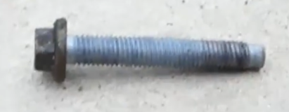

Were these Bolts the Rear most Lower control arm Bolts? as those are a 15mm*

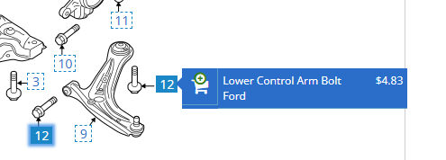

Trying to get a definitive answer on what the part numbers are for the two bolts use to mount the lower control arms. I replaced wheel bearings & ball joints last weekend (for the second time) and ostensibly will be doing it again in the future. I'm making a parts list to just prep everything for the next go-around. The only speed bump I have run into is the parts number for these two bolts.
I didn't think to take photos of the bolts when I did the job since I didn't think it would cause me trouble. There are two bolts - a front and rear.

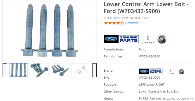

When I browse all of the Ford parts websites, there's only one listing for both bolts:
Click the link and this pops up:
This appears to be correct for the rear bolt, but the front bolts are different.

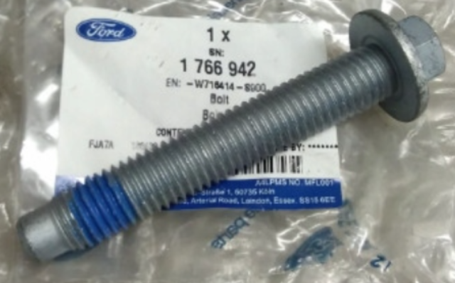

A bit more poking around watching install videos, I finally narrowed it down to what I think is the correct part number:
W716414-S900 Bolt :
Here's an eBay listing at about $50 shipped for two.
It looks like Whoosh Motorsports has them for sale, $70 (for two):
They also appear to have an aftermarket version at $37 for two:
My questions are, is this the correct part number? Why can't I find it listed on any of the big online parts retailers? Is this a discontinued item? I'm thinking Whoosh is the best source for these. Just wondering if anyone has any insight. Thanks!

Hi Sluggyjunx,
Rear Vertical LCA Bolt= W703432-S900. M12 x 73mm.
Front Horizontal LCA Bolt= W715977-S900. M14 x 80mm.
I believe both of the above bolts have a thread pitch of 2.0 but not 100% sure.
The part # you were referring to W716414-S900 I believe is the U.K. version of W715977-S900.
