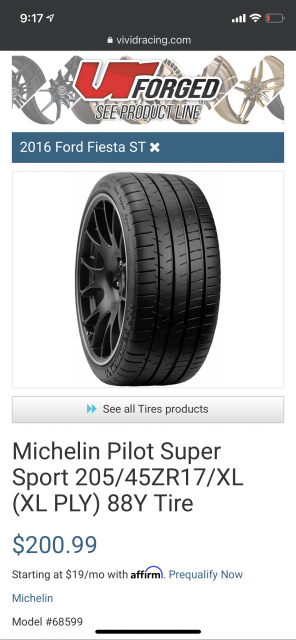

Hey guys/gals,
I’m trying to find a tire that has turn in like the OEM RE050A. I see these Michelin’s are 205/45’s and was wondering if anyone has ran these? (On 17 in OEM wheels)
