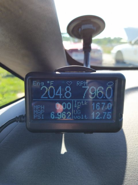

I have that very same device, and use it to monitor coolant temps and boost FULL TIME (I leave it in the car always) instead of the AP that everyone else uses. [thumb] (MUCH less likely to tempt any thieves than the pricey AP!)
The 'interpolated' oil temp is the only thing it gives up to the AP. [wink]
