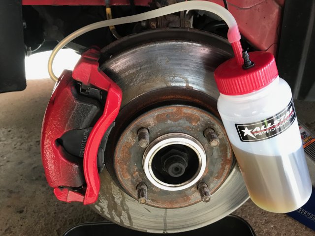

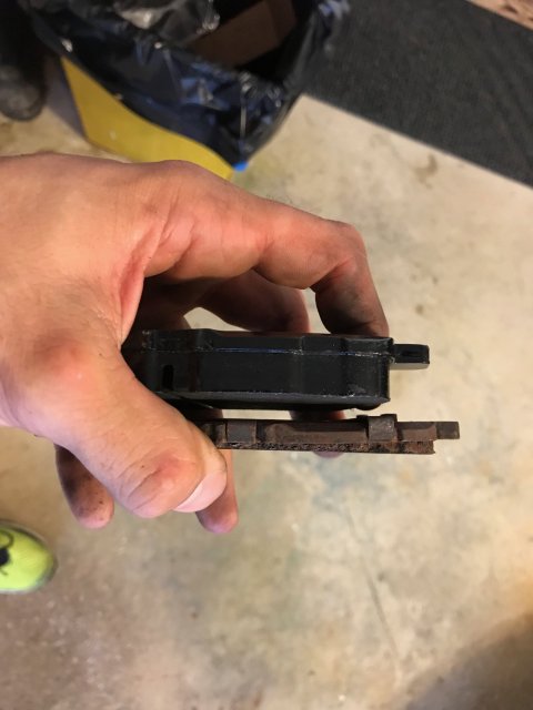

I have a Pumaspeed hybrid with over 30k track miles. I change the oil with Liqui Moly 5w40 Hi Tech (910s oil filter) every three hours and run a large Mishimoto radiator and their thermostat. I attribute its longevity to this habit. I flush my brake calipers frequently (track dependent) with ATE Type 200 (higher boiling point than Motul 600) and swap Motul Gear 300 annually (MFactory LSD). Zero mechanical issues and I track 2-3 times a month at least. My brakes (ST40 front FoRS rear) aren’t popular here due to wheel fitment requirements so others will have better advise for stock setups. RT660 and A052 are fast lap 200tw tires but you probably already know that. I use 17” wheels so I’m limited..
