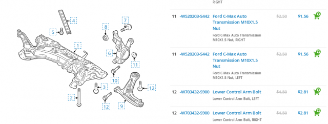

So I have been having long term problems with getting the bolts on my Pierce 4 point brace tight. The service manual states that the bolt in question is to be tossed and a new one is to be used when its replaced.
Looking at Tasca, I am thinking it is #12 - W703432-S900
I have a pack of 4 of these. They are the original bag with proper label from FordParts that I got from Tasca. These bolts have the proper look to them, but they are not the original bolt. Their head is 15mm, Originals are 18mm. I have not pulled the original bolts to compare threads / length (my kid has my tools at the moment)
Am I looking at everything correctly?

Could it possibly be item #10 also listed as a Lower Control Arm Bolt?

i like how it says "c-max" :eek: are you in the right section on tasca?

I went directly to Tasca Parts and looked up my '14 FiST, (same page as posted above).
Item #11 (nut) says C Max, item #10 (bolt) does not.

Never mind,
Item #10 is the knuckle pinch bolt for the Ball Joint stem.

Ford parts actually shows 2 different bolts for the one hole. Both are listed as for the ST. So weird. I am ordering a set from Tasca.

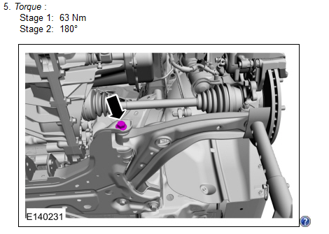

I attempt to get to the spec. I don't have my book in front of me but something like 60nm then an additional 180 degrees. I can never get the whole rotation with my breaker bar. I may get a steel pipe extension.

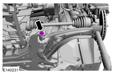

The website doesn't directly link properly, but parts.ford.com . I select that I am a do-it-yourselfer, enter the car info and go to the suspension area, then chassis parts. The Arm Assy - Front Suspension has that image.

As somebody liked my post above with the torque spec, I am pasting the actual spec from the service manual.
