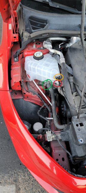

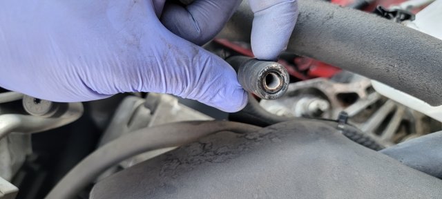

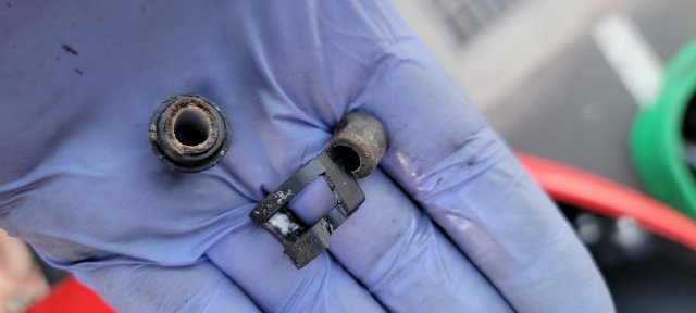

Trying to fit things back in... the bottom (circled in green) hose fit no problem. The top two... they don't want to press in far enough to click into place. For the middle connector (circled in red), I pushed and pushed and it looked like it was right about to grab the lip when it broke. I tried connecting the top tube (circled in orange) as well, but that one also doesn't seem like it wants to go in far enough.
Tried connecting the top tube to the stock tank and it clicked in no problem.
1st question... what's the part number for the middle connector (or do I need to replace the whole hose)?
2nd question... I got the Dorman 603-381 tank which says its for the Fiesta from 2011-2019. The tank fits perfectly on the mounts for it and the bottom hose fit perfectly. Just the upper two seem not to want to go in. Anyone have this happen to them?

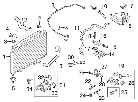

I think it's #10 here that needs to be replaced which should be:
C1BZ-8B081-J
