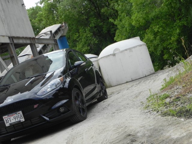

Hey! I just bought a '17 Fiesta ST, with 4,100miles on the clock basically brand new. I am absolutely in love with the car, I've always been a 90's honda/acura guy until now.
Anyways I ordered a Whoosh FMIC and a Cobb rear motor mount after talking to some fellow ST owners. I have read that our little engines are good for around 385 whp and 425 tq, correct me if im wrong but I want to eventually make around 300whp. I have a daily driver but I want to make sure its reliable. I want to be able to take weekend road trips and still get to work monday, actually thats the reason I bought this over a Miata (backseat space). I am looking at a cobb accessport next. I am thinking about a custom 93 tune from stratified. I would jump to e85 but i'm too lazy for an e30 blend.
I guess what problems should I look out for and what should I do next on my road to a reliable 300hp?? Thanks!

Lastly to OP welcome to the forums and it's a great looking ride. I have a shadow black '16 without the black wheels but love the way they look.
