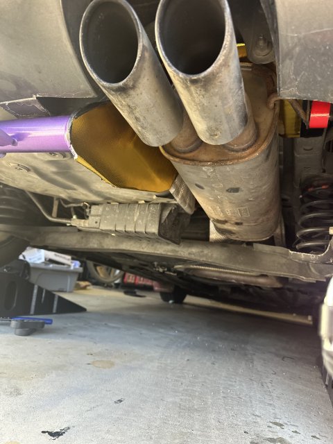

minor mods so far. Got a pedal spacer and a hitch receiver for a bike rack. The muffler knocks on the receiver. I got some new hangers and some heat shield tape to pad the metal, but haven’t managed to quiet it to my satisfaction yet.

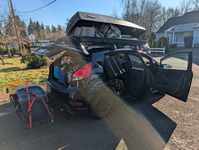

I got one for hauling equipment, but I've hauled pedal, ICE and EV bikes on it. It's hilarious when I show up to a trailhead with bikes on this thing.
Because of how light the fiesta is I would think twice about a trailer on this at all. The hitch mount is near equivalent and is way safer.

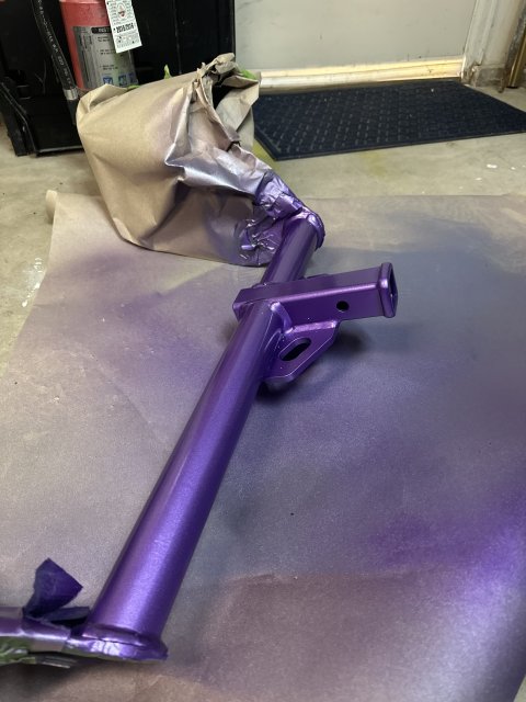

I got the banging to stop. I installed whoosh polyurethane hangers on the rear two exhaust mounts. I also pulled the hitch, and used some sound deadening sheets and gold covered fiberglass heat shield to give it some padding and protection. I painted it purple because I have free will, time, and a can of purple paint.
