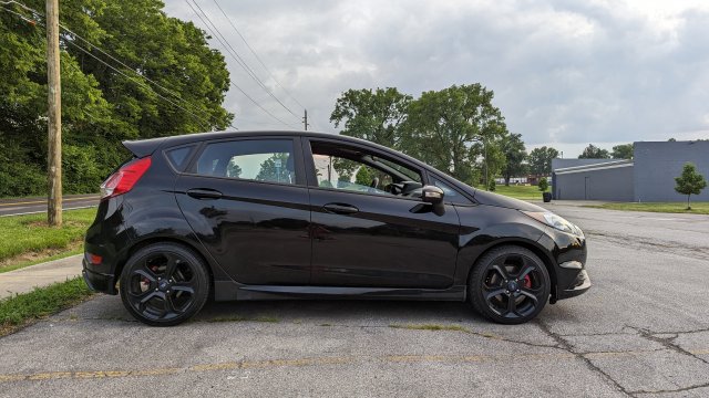

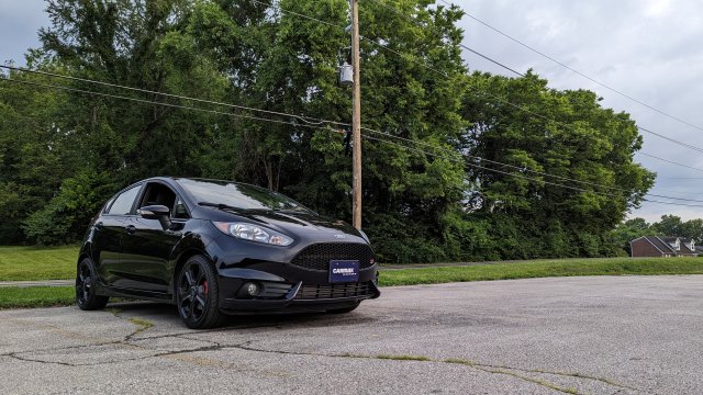

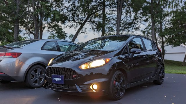

Found this 2018 FiST on CarMax and bought it back in June. Excited to get into it! I've been having a ton of fun driving it around as my daily.
~40k miles, lived most of its life in Maine, was listed for sale in Maryland, & had it shipped to me in IN. A little bit of rust as expected but could be worse.
Stock as far as I can tell except tires. Previous owner seems to have swapped tires a lot per the maintenance history, presumably due to northeast winters. I thought maybe it had been lowered some too, but I don't really know
I've been reading through a lot of old threads on here since I bought it. Trying to get familiar with the car and community! Also trying to get used to some noises, figuring out if everything is normal, etc. I've definitely noticed the "Darth Vader" induction slurp, but I've also got a similar but kind of slower repeating whoop/squeak at slow speeds and low revs that I'm not sure if is normal.
Pics are from when I first bought it. Don't worry, I've taken the CarMax vanity plate off
First planned addition is definitely an OCC; I was surprised to see it was run for so long without one.
After that, maybe going down to 16"s and slightly thicker tires; I've been looking at white sparco terras and BFGoodrich G-Force Comp-2s as a year-round setup. Also maybe some more cosmetic changes like weather guards, new fogs, etc. No real plans to increase power any time soon.

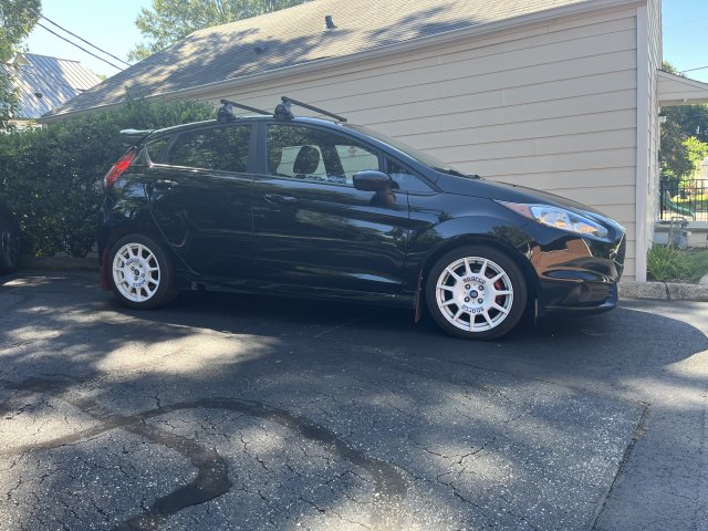

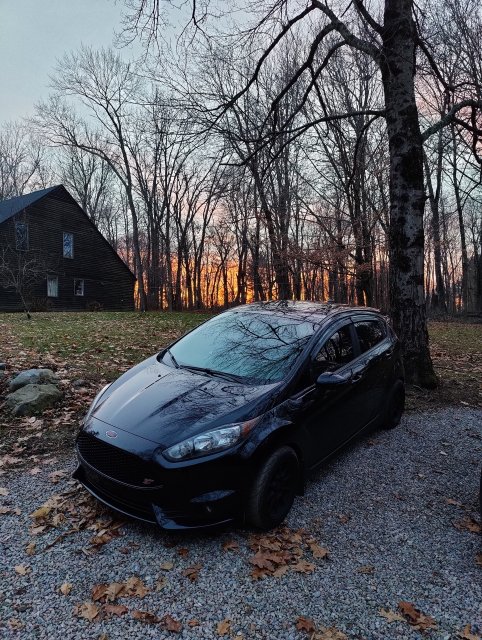

In case you’re curious how white Terra’s look on a black car, here’s mine. I personally love the look.
Wow they look great, thanks for posting a pic!! The roof bars and mudflaps work great too! Did you have to change anything in the suspension to accommodate the 42mm offset, or did they fit okay?

Nope, they fit fine without any rubbing.

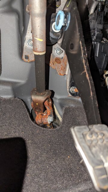

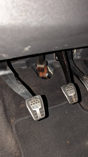

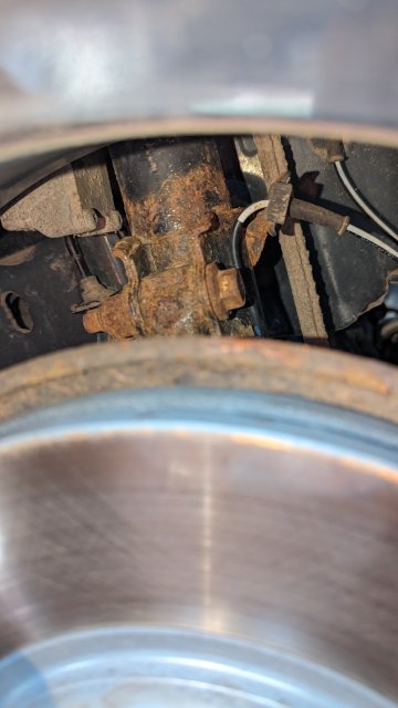

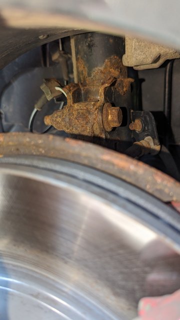

I'm not sure exactly where the rust started first, but I've noticed it in a lot of places. Especially on the suspension components, in the wheel wells, and even in the joint in the steering column down by the petals. I'll attach a couple of photos here. In those places, the rust seems to be most prominent on the bolts and welds. I think the wheel wells are rusty in part because the plastic covers don't fit perfectly against the body work; there are some gaps between the shields and the outer metal for water/salt to get into and get trapped. I'll get a pic of those gaps if i can later; i don't think I have one handy. PXL_20230702_180805499.jpg PXL_20230702_180811525.jpg
1) the rusty joint in the driver's wheel well; I believe this is the steering column?
2) a rusty front lower mount
It's worth noting I haven't gotten the car up on a lift and looked at the undercarriage myself yet, so I'm not sure what the rust looks like under there. I did take it into a dealership during the first month (Carmax's return window) to make sure there was no structural rust or anything catastrophic. They gave it a clean bill of health, but I'm not super confident they were as thorough as I'd like based on my conversation with them afterward.

Yeah, nothing you're posting is too surprising. Some folks' cars (according to reddit anyway) shipped with a rusty steering column, but I'm sure driving around with salt and snow on your boots doesnt help the pedal box. For the knuckle mount, i'd probably start doing a liberal application of PB blaster before the winter. It doesn't look like anything but surface rust, so if you have an angle grinder and a can of rustoleum you could bring it down to bare metal and paint it again. That's what I'd be tempted to do since we love our salt.
Keep an eye on your pinch welds, those might need some attention too. If you've got the money to spare, I'd consider some kind of underbody treatment if you plan on driving it all year round. The engine might never die, but the body will succumb to rust if you let it.

Will do, I appreciate the advice! I was definitely concerned about the rust but wasn't super sure how to go about treating it or preventing more

If there's rust on it, it needs to be ground back to bare metal and painted/sealed. Fluid Film and Waxwool are popular rustproofing treatments, but again, if there's already rust there, it needs to be dealt with first.
