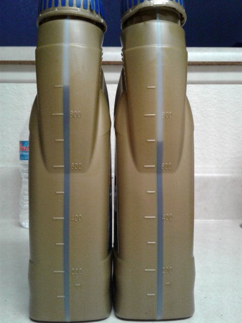

Dropped what came from the factory at 2K, then poured in the full 2L of Ravenol. Dumped the factory fluid into the 2 Ravenol empties. Guess mine was sent out with the old spec 1.5L. Luckily no strange mechanical sounds before the change or thus far.
