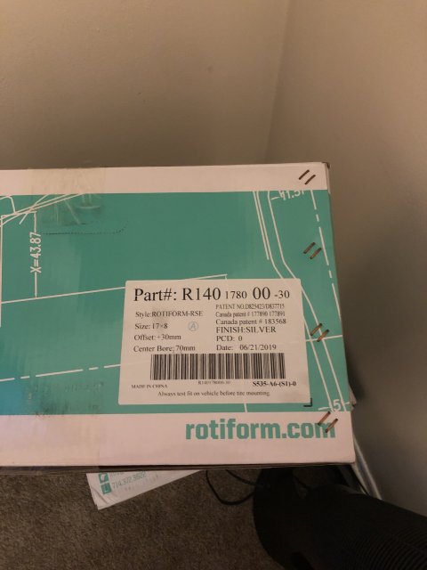

Hello I recently bought some new wheels Rotiform RSE, I ordered 17x8 40 Offset. I got the wheels in today and they are a 17x8 +30 offset :(.Can I still run them or is it a bad idea?

They will most likely poke. Willtheyfit [SCAMMER ALERT] is what I always use.
I've heard that 17x8 et40 is the perfect "flush" fitment, but I've haven't seen it in person yet.

lol +30 is so low for our cars, i wouldnt recommend it. i would get a full return for that if i were you. sorry about that btw :( ive had something similar happen to me too

That sucks... but I would echo everyone else and say get them swapped out for what you ordered. I'd try to get them to cover rush shipping, but that's probably a stretch considering the size and weight of those boxes.

I'm running 17x8+35 VSXX and I can barely fit a 205/40/17. I rub if I push the car.
You'll likely need a roll and pull/stretched tires if you run that wheel.

et40 is probably the furthest I'd want to run on my own car being lowered and all (BC Coils). I push my car in autocross and backroads so fitment is very important to me. I've had 17x8 et 40 and I would rub on large compression's. I can only imagine how bad I would rub on an et30. I would return them and get the correct offset
edit: I'm not that low, on my 17x8 et40 setup I had a 2ish finger gap and I occasionally rubbed on the street. At autocross I managed to rub through my fender liner on 215/40/17 Federal RS-R's

Hello everyone thank you all for your feed back. I was actually able to send it back to where I brought my wheels from free shipping and a discount.😊 All worked out in the end. Thank you everyone for your insite. Love our community!!!

To the OP if you are running 17’s then yes 40 is about as low as you can go offset wise on our cars. If you are running 16’s you can get away with +35 depending on tire size and brand.
If you are running 15’s the door opens a little more and there are many tire sizes as well.
Though ya without at least a roll if not a pull as well you will not fit +30 in 17’s in their.
