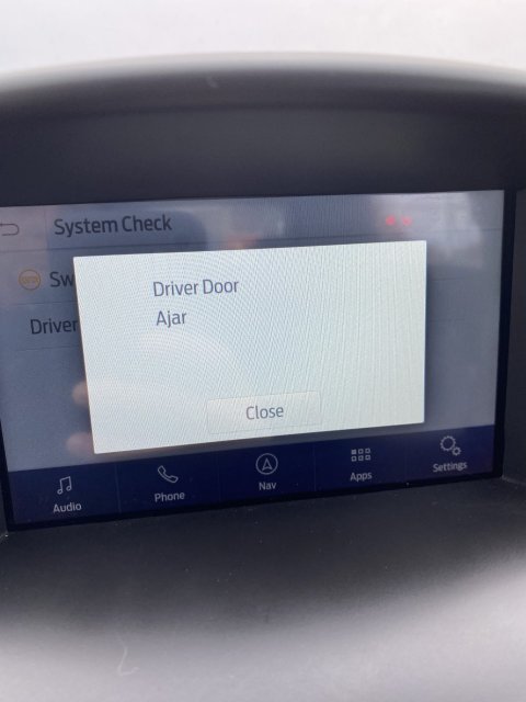

The door ajar light comes on randomly for about a minute or sometimes stays on for hours, really annoying. especially when the alarm goes off at night. Though I have figured it out! The annoying thing about the Fiesta is it doesn't tell you which door as ajar. But...if you upgrade your Sync software (I did via the Cyanlabs updater worked perfectly, I have version 3.4 build 22251) which door, or hood or trunk is open will now show on the screen! Flipping sweet! I assumed mine was the trunk but it was in fact the hood that keeps popping up as open. I'm trying to decide if I should just jumper the connection to save money or buy a new latch assembly. I'll attach a pic of the screen showing the driver door open.

Check to see if your car has any recalls, there was one for door latches.
Thank you. My vin was not part of any recalls. Since this post I was in my car and the hood open warning came up on my screen while I was driving. That was the culprit, I ordered a new latch assembly.
