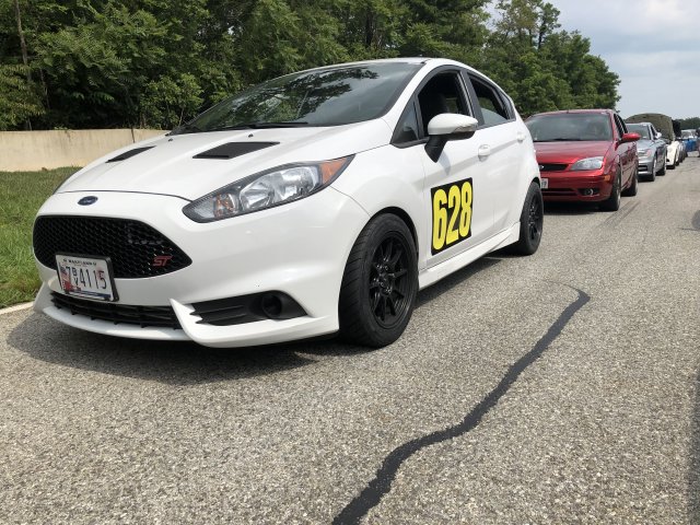

Mine didnt raise the car at all. I ran the B8/Swift combo for quite a few years and the drop was as advertised at 1"(give or take a hair). Below is the B8/Swift springs on 15x8's and 225/45R15 RS4's.

But be aware, that tire Kevin is running in that pic IS a little bit shorter in overall diameter (by at least a half inch, if not more) than our OEM setup's height, so the wheel gap will be even closer yet on a 215/40-17, 205/50-16, etc. [wink]

This. Always look at tire height in relation to the original height of 23.4". The 225/45R15 is only 23" in tire height so they are shorter than the OE size.
A good reference at this point is stay as close to OE tire height as you can but widen the tire as much as you can. The car needs as much grip as it possibly can get. Some approx. measurements from Tire Rack on sizes:
