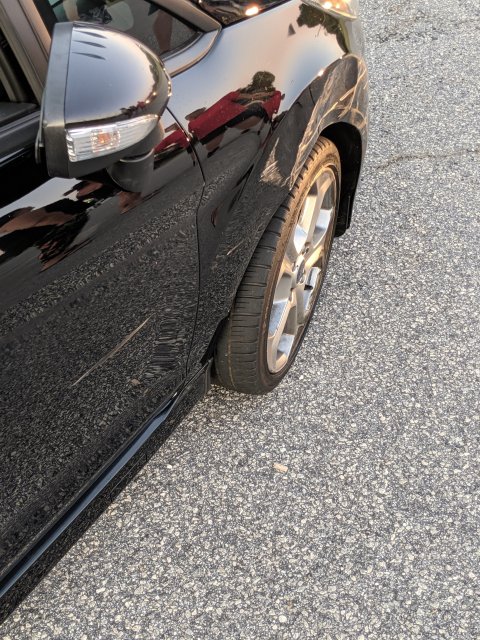

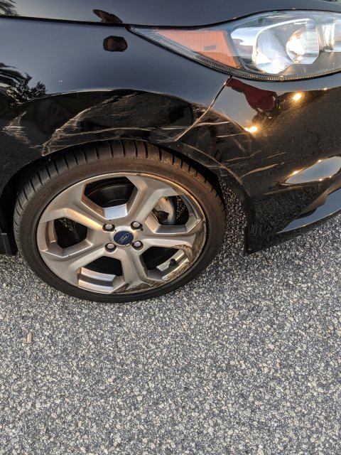

Ok so I have to admit I've been playing with the idea of buying a totalled fist just to build race car. But with just having an accident and denting the fender and snapping my either tie rod or steering rack end and messing up the door and fender. So wat I'm wondering is what are yalls opinions on that

Not yet ND yes pics have them lucky me it wasn't my fault

That totaled out the car? Yeesh, looks like minor damage - if you can buy it back for cheap it seems like a great start to a project!

Insurance company wanting to "total" that would be some crooked shady shtif. You *never* know what you'll get into underneath it all, but bumper cover, fender, repaint the door, pull/pound out the wheel well and prime it, wheel and tire, possible steering linkage components... guesstimation 3-4k for a guy off the street... add another $500 or $800 for a woman off the street... 5k for a business, 6 or 7k for insurance and 14k if govt is paying for it...
You have to take care of your primary ride before considering something as optional as a project race build. We don't know anything about the condition of your current vehicle, but assuming its spent its entire life down South and away from the coast, rust is not really a factor. If the oil has been changed regularly and the engine solid, it is better to fix what you have versus start with a new car payment. (provided it is fixed right)
If all this costs you little or no money because the other party and/or their insurance isn't trying to bend you over, then this wreck changes nothing but time.

I agree 💯% Monday I'm having it towed to the ford dealership and getting it fixed hopefully it won't take forever. I wanna use the car as my daily/weekend track car long term.

Nowadays what totals a car is if the Air Bags go off, with some cars that alone can be up to a 14K hit. If the airbags didn't go off that is repairable but you'll want to see the measurements of the front end alignment immediately after the repair and don't sign off on the repair if the alignment is not within the factory specification. Because some shops will straighten the body until it looks good and call it done. When that happens you can end up with a car than cannot be aligned to spec and eats tires like salt water taffy. So tell the body shop up front you will not sign off on the repair until a third party shop passes the alignment as good to go.
