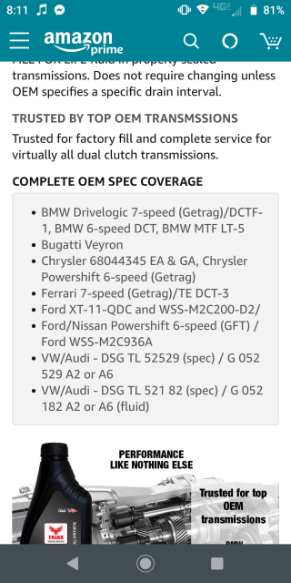

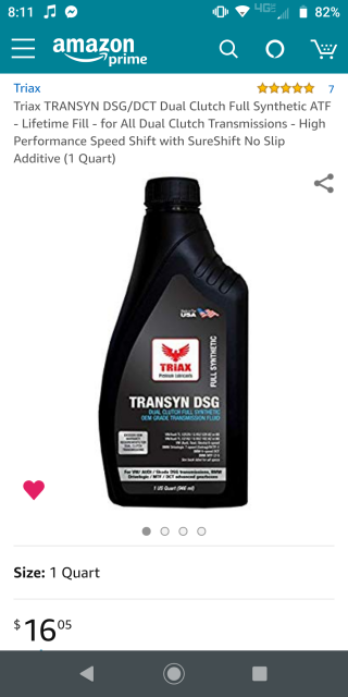

I've been trying to get a straight answer but everyone uses the pricey stuff, so can GL-4 be used in our transmission? All I could find locally here in south Texas is 75w-90 gear oils which are rated GL-4 and GL-5. The full synthetic oil all say they are for limited slip differentials/hypoid. I also found a manual transmission fluid that is for synchromesh type transmissions. Which of these would be a good substitute for the more pricey options like Royal Purple, Redline, Moutul, Ravenol, etc..
The only one that is close to our Ford specs is the Valvoline MTF for synchromesh type transmissions it's spec rating is WSS-M2C203 A-1 and A-2. I will be trying the Triax stuff but for future changes if I can save money I will.
Any information is appreciated
