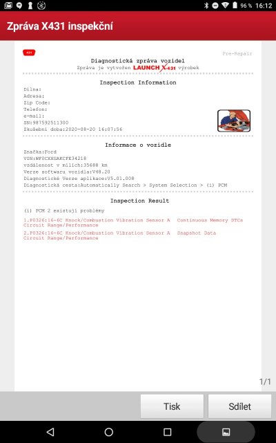

In my 2015 Fiesta it was pinking. Due to carbon deposits on injectors and inlet valves.
Using fuel cleaning additives I am free of it.
Inside the EMU was always:

About 22,000 miles! WOW! That's low mileage for buildup..... How often do you change the oil? And what Type of fuel cleaner did you use?
#12178
68
38
First of all I started to use 98 octane fuel instead of 95 octane fuel and it was better but not solved.
After that I started to use 100 octane fuel and it was even better.
Then I ordered ELF PERFO 105, which is 113 octane fuel and the problem was over, but the fuel price was crazy.
Oil changes every 7500 km https://www.aci.cz/mi-79535-millers...olej-triesterova-technologie-5-l_d295915.html
Additivum: https://www.autokelly.cz/Product/AC-VF019/9420398
Millers is good stuff, but a 4.08 HTHS is a bit too thick for these engines, unless one is constantly open tracking their FiST in the extreme heat (or running a long stretch of steady state 230+ KPH speeds on the Autobahn, or any of the other Euro super-highways).
That high TBN number could also indicate a very high calcium/sulfated ash content which would/could also lend itself to intake/injector/combustion chamber deposits, as well as possible LSPI. [:(]

#20
Well.
No engine has crashed yet because it did not use the best possible oil, but every engine crashed when it had no oil.
The oil I use:
Has the fully syntetic base (PAO and esters)
Has change every 7500 km
Has oil level check often
The engine has maximum 3000 revs and small load until the engine oil temperature is 60 deg. Celsius.
So I will continue testing my new suspension setting, assuming that the engine has good working conditions
