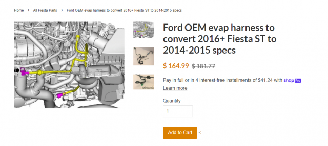

After about half a year with this harness from whoosh, I am getting a cel for a p1450. Does anyone know what I can do? I keep having issues with the purge valve.

The assembly is $150 shipped, but I also bought just the valve. I'll use it with braided lines as a backup/future replacement (fingers crossed maybe @150,000 miles!). Course gas will be $150 a gallon in our post-nuclear world...
