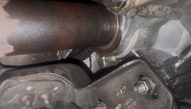

I’m in need of opinion, my 2015 fiesta st has started to make a noise, had a look under the car and noticed an oil/grease leakage. Is on passenger side of Australian model
Has anyone had similar issue and what resolution did you come to, cost and labour etc.
Thanks, any advice appreciated

what kind of noise? any vibrations at speed?
That axle seal is definitely gone, but might not, as stated above, be the only problem.
