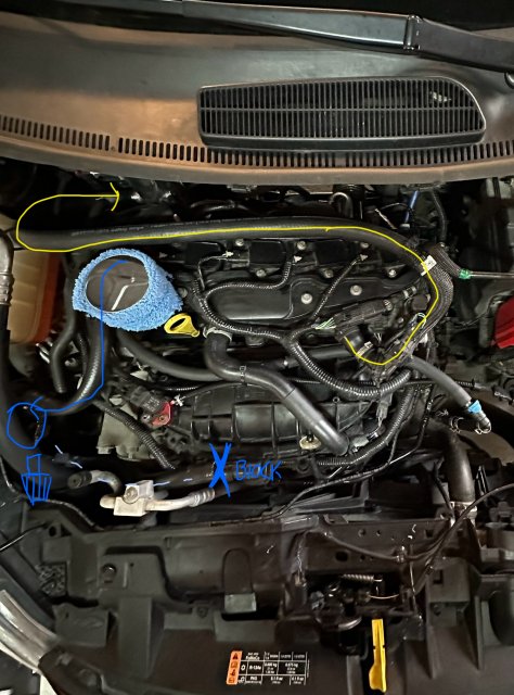

Hello everyone, I’ve been slowly modifying my stock pcv/crankcase vent system because of some issues I was having. I started with a radium catch can for the vent that goes to the intake manifold. I also have a 2JR intake with the other crankcase vent routed there. The intake-side does not have a catch can since I’ve never really had much oil go through there in the first place. Do note that these two mods were done before I had any issues.
Everything was great until the car started burning oil on decel after high-boost pulls. So, I did some digging and asked a lot of people and concluded that it was something related to the pcv as I found a LOT of oil in the pcv line that goes to the intake manifold (even though I have a catch can…) My guess was that the pressure inside the motor had nowhere to go and ended up shooting through said line straight into the manifold. Also, I think boost might’ve been creeping up into the pcv line and into the catch can.
To test, I went and got a cheapo autozone oil cap breather replacement and wrapped a towel around it to prevent oil from spraying through. This worked and stopped the issue I’ve since gotten a baffled breather and a check valve for the pcv line that goes back to the intake manifold and the issue still hasn’t returned (thank god).
To figure out a more permanent fix I wanted to get some feedback on a possible pcv breather. This would involve turning the existing catch can into a catch can with a breather and completely deleting the side that goes to the intake manifold.
Basically, instead of
Valve cover vent -> Catch can -> intake manifold
it’ll be:
valve cover vent -> catch can -> atmosphere
What do you guys think?
