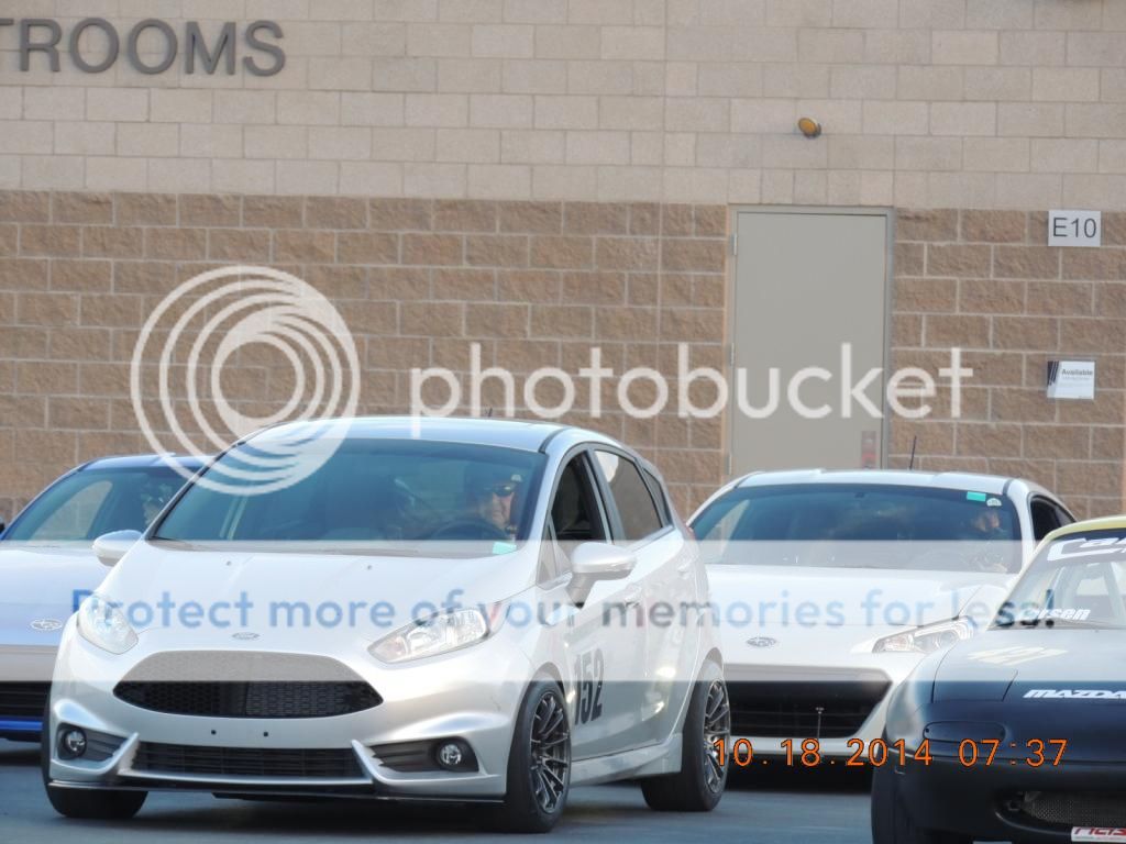

The car sits lower than it looks, the short tires make the wheel gaps look bigger than they are, I am going to lower the rear a tad bit more. 225/45/15 tires did not rub.

Very nice stance Rick.

They stick out a bit less than it looks, I am exploring ideas to divert the air around them, probably just flat sheet material in front of them but not all the way out, it only has to go out just enough to push the air out so it does not hit the spinning tires.
On the front I may widen the splitter and to some sort of dive plane if I can come up with a simple and not to standout looking solution.
The front wheels were very close to the struts but I thought would clear but with those sticky tires I rubbed them a little so tossed on some 5mm spacers I had on hand as already have ARP studs on all 4 corners but then it was not hubcentric but did not seem to matter, no added vibration and it handled a bit better with the wider track.
I had some 1mm ones I made at home and going to make another pair a bit thicker so I can maintain hub centric and just clear the struts, bringing the tires back under the car a bit a the same time.
I am considering 15x8 street wheels, my wife loves the look of the race wheels but the come in +25 and would not be a great offset for the geometry. I am looking at other wheels but might now find a 15x8 or 15x7 that will work. The widest good 3 season tire I can get is a 205/55/15 so taller than stock which is OK but not a good match for the purpose on a 15x9....

looks great. yours is def a sleeper. surrounded by race prepped cars. and your st faired extremely well. !!![ninja]
