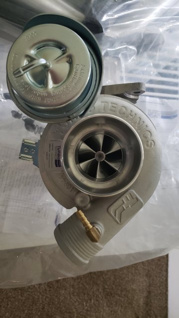

Parts are taking a long time to arrive, but the S280 came in today. What started as an idea is about to get real.

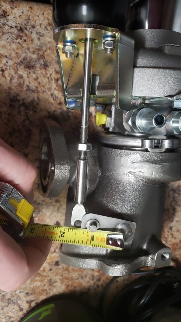

Update: I'm finally having my turbo and i/c installed next week. I went to install the upgraded Tune+ wastegate actuator on the turbo and am wondering if there's an issue. The wastegate actuator rod is about 7/16" away from the wastegate valve arm. I can force the rod over, but it seems like that would bind against the bracket holding the actuator possibly and put unnecessary stress on the rod/actuator. Am I missing an extension or is this normal? See pic. 16201645648602358955016010087931.jpg

Update: I'm finally having my turbo and i/c installed next week. I went to install the upgraded Tunes+ wastegate actuator on the turbo and am wondering if there's an issue. The wastegate actuator rod is about 7/16" away from the wastegate valve arm. I can force the rod over, but it seems like that would bind against the bracket holding the actuator possibly and put unnecessary stress on the rod/actuator. Am I missing an extension or is this normal? See pic. View attachment 40301
Half inch is long way off keeping the rod straight. Something is wrong there. Dont just pull it over; it can't touch anything or it will bind; has to move freely.

Thread Starter #20
That's what I thought. I figured something was wrong when I took the stock actuator off and it needed a lot of side pressure to pull off the arm. It sort of sprung back to its original placement after I slipped it off the arm nipple.
I wonder if the arm was built too short or if I just need some sort of extension. Based on the actuator bracket placement, which looks like it can't be adjusted, I'll need to fab some sort of extension?
