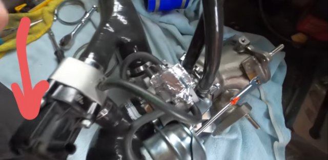

Question: On every S280 setup I've seen online, the bov adapter that comes with the kit has what I'm guessing is the stock diverter valve attached to it (see pic). Since I'm running a bov off the symposer port, my bov adapter has a plate blocking where the diverter valve would be. Since the vent port of the solenoid is attached here, how does pressure get vented with a block off plate when wgdc is increased? Sorry for the basic question but I'm still learning. Also feeling like I'm chasing my tail due to that lack of knowledge 🙄
