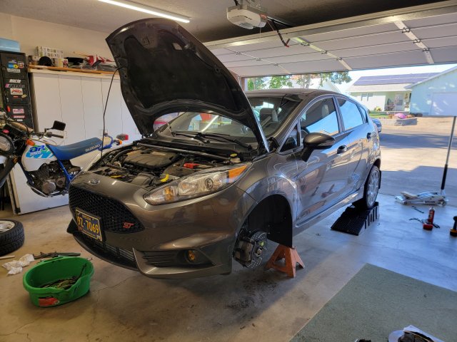

Could you bleed all 4 wheels...Now? I know the Europe folks have that option. Hopefully we do now also with Forscan.
No, it didn't work. All I could do was bleed the abs system. I had watched Spark Plug Steve's video on it and really couldn't find much else. Ended up just doing it manually with one person opening the bleed screw and one person pumping the brakes.

Bleeding the ABS system bleeds the braking system. I can do a how-to if needed but I followed spark plug Steve's video.
Please do. I ended up bleeding the abs system and the pedal firmed up, but would slowly sink to the floor. I had some motul 600 laying around I used to top up with, but I think I want to replace all the fluid. Pedal got a little soft after a spirited drive.
