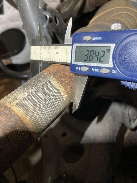

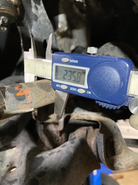

Today. measured na versus ST 8788D483-7FA8-49C9-AA16-C8BEE8D39E1B.jpeg DADC6EA8-C620-4604-B428-19E04BCE393C.jpeg

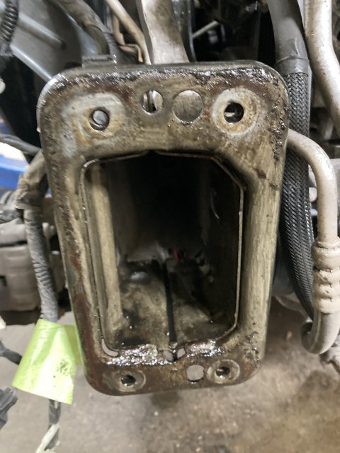

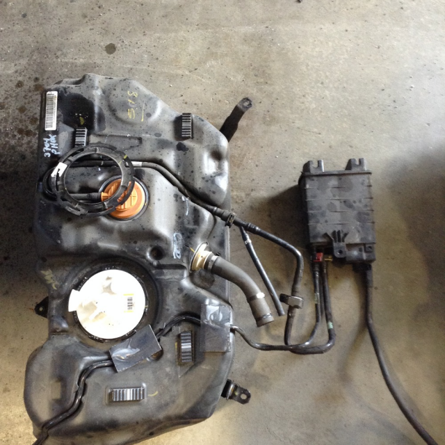

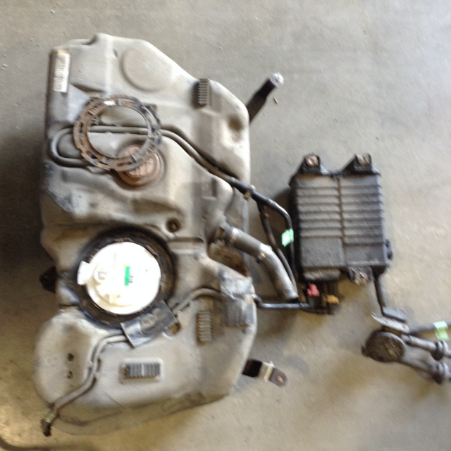

Fuel tanks have the same PN on the 11 sedan and the 19 ST, however the EVAP system is different. The 11 canister is larger and has a separate vent solenoid with 3 pins. The 19 has a vapor pressure sensor on the line going from the tank to the canister and the vent solenoid is part of the canister itself with only 2 pins. The 11 canister mounts up between the tank and the spare tire well. The 19 canister mounted on the bottom of the spare tire well. The plan is to fab a bracket to mount the smaller 19 canister where the 11 larger canister was. I will replace the hard plastic lines with rubber hose since the 19 lines won't line up now. Fun times. 1649849030764.png 1649849001535.png

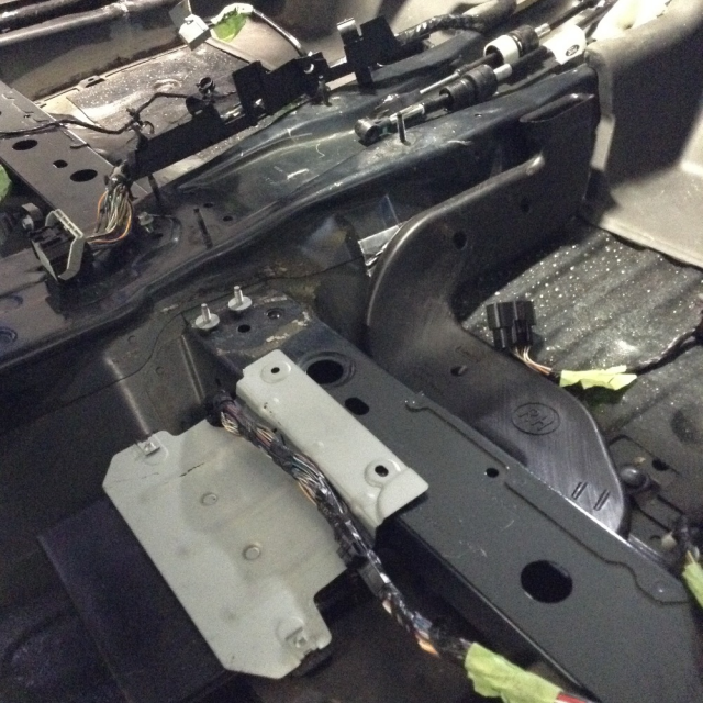

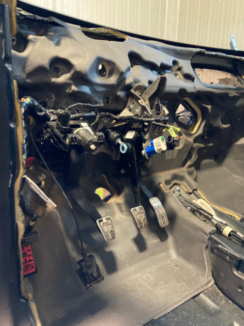

The 19 ST inside body harness mates up fine into the 11 sedan front section with the exception of the module under the passenger seat. There are no welded nuts on the floor brace so I will probably use self tapping screws and 3M tape. The carpet lays over the module anyhow so I'm sure it will be fine. 1649850204790.png
