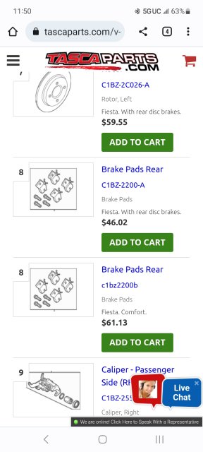

Now this is from Tasca parts. Probably one of the number one places that people buy Ford parts from. You will notice both for front and rear you have 2 different pad options. We call them summer pads because they came on the car's with summer tires from the factory very simple to understand.. Screenshot_20230523_115000_Chrome.jpg Screenshot_20230523_115027_Chrome.jpg

The "Comfort" pads are standard pads that come on the NON performance version Fiesta. Other than rear pads they match up and the titanium came with rear disc so that is why you see that option. The ST pad is the ST pad. There are not 2 options. You CAN get the comfort pad and that is what is standard on ANY fiesta. The ST did not have 2 seperate pads. When you ordered your Fiesta, same as when I ordered BOTH of my Focus ST's you opted for the tire but in no way did it change the pad and adding A/S was MORE expensive not less due to less pad quality. Unlike the mustang with track pack and the like you get different brakes all together but there are not different compounds for brake pads in any Fiesta ST.

OE Ford Motor Company Listing:
AY1Z-2001-E - FRONT PADS - MANUFACTURER CALL OUT "A/S TIRES"
AY1Z-2001-D - FRONT PADS - MANUFACTURER CALL OUT "PERFORMANCE"
AE8Z-2001-C - FRONT PADS - MANUFACTURER CALL OUT "W/ FRONT DISC/REAR DRUM"
CB1Z-2200-A - REAR PADS - MANUFACTURER CALL OUT "PERFORMANCE"
CB1Z-2200-B - REAR PADS - MANUFACTURER CALL OUT "COMFORT"
8V5Z-2200-A - REAR SHOES - MANUFACTURER CALL OUT "W/ FRONT DISC/REAR DRUM"
Motorcraft:
BRF1508 - A/S TIRES FRONT PADS
BRF1507 - COMFORT REAR PADS
BRF1444 - PERFORMANCE REAR PADS
BRF1494 - PERFORMANCE FRONT PADS
Good?
*to clarify, i posted the front disc/rear drum part number to show the regular Fiesta has different part numbers than the ST model.
*also, dont know why but the Motorcraft listing likes to flip flop between being called "comfort" and "A/S tires" dependent on who is the vendor.

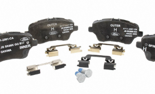

Also, another indication the differences between the pads using the numbers painted/stamped onto the backing plates:
H stamped on them in white equals the A/S or Comfort pads.
S stamped on them is the performance pad option.
Also, the coefficient of friction rating of the pads is within the friction code listed on each set of pads. The breakdown of the alphanumeric part number is PA = manufacturer, 4645-2 is the pad formulation code, GG is the coefficient of friction range the pad is formulated to in low temp friction performance and high temp friction performance(GG = .45 to .55 CoF) and A15 is the environmental compliance code A(does not contain cadmium, lead, asbestos, chromium or mercury) and the year of manufacture 2015.
H and S pads are made by different manufacturers, with different compound designations, use the same friction coefficient ranges(GG for both which equals high/low temp friction performance of at least .45mu up to .55mu) and with different environmental impacts. The H pads are more environmentally friendly than the S pads.
