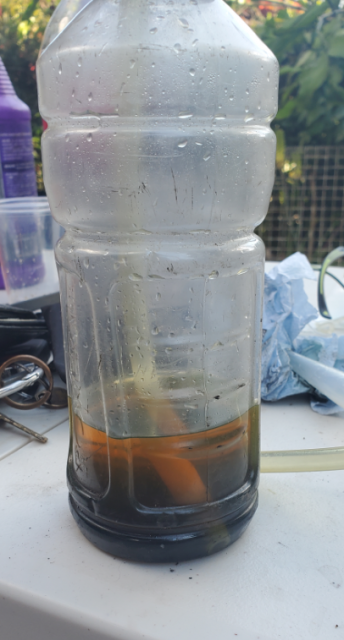

The picture is just the flush from the clutch line
I was doing full brake job on my car, and when i do that, i always flush the clutch
Brake lines and clutch line share the same brake fluid reservoir
after the flush, clutch feels better
