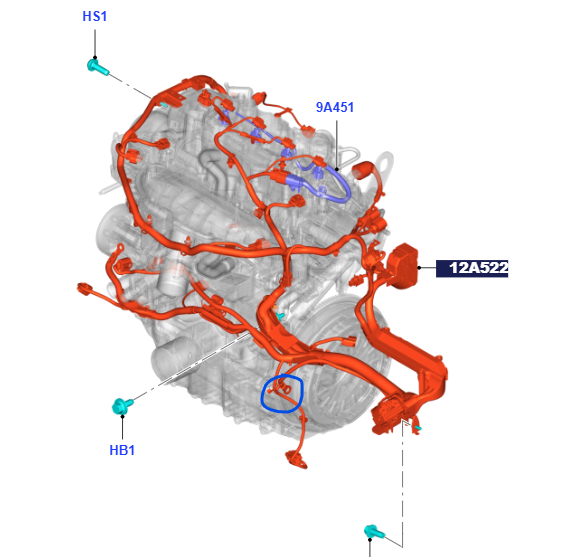

Thread Starter #9

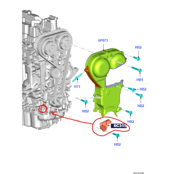

After work I'll check my ground as well. (If I can find it, I hate dealing with wiring harness stuff) I have the purge valve coming in today (Just the valve, I'm going to DIY this because I don't really want to spend $200 on the whole harness) so I'm likely going to try these two items first. I did previously replace a Camshaft position sensor on the intake side because while troubleshooting with Forscan it looked like data from that sensor was intermittent. Couldn't find the Crank position sensor value in Forscan or I would have checked that one too.
Where's the Crank Position sensor located on our cars?
I think the ground we are after near the starter is the one that loops around and is tied into one of the transmission bolts. (But I'd check whichever ones you can find)
The crank position sensor is on the back side right by the crank pulley, just one bolt holding it in.
