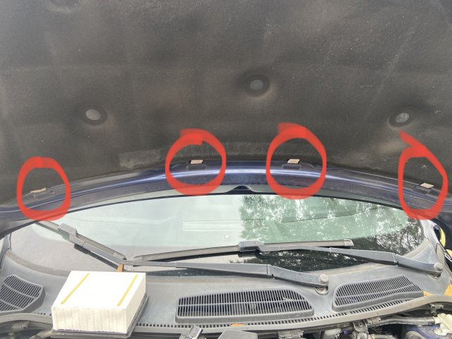

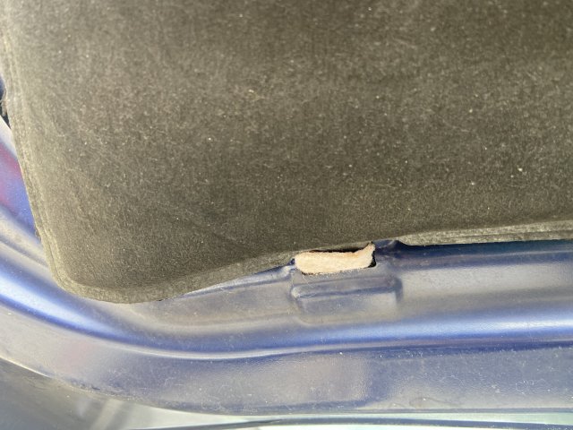

for anyone having this same issue, i just discovered yesterday that the black insulation on the hood has 4 small tabs towards the rear of the car that slide into slots in the hood; these were causing a rattle at idle. Wrapped them in some sticky felt and reinserted them into the hood, annoying rattle gone!
Pics of part with issues for the people*
I wrapped some sticky felt for furniture feet I had laying around. Higher heat resistance felt, fills the gaps so the plastic tabs don’t rattle.
