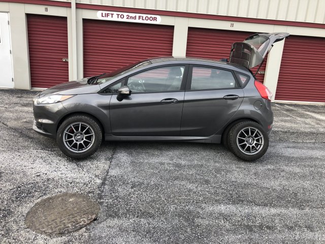

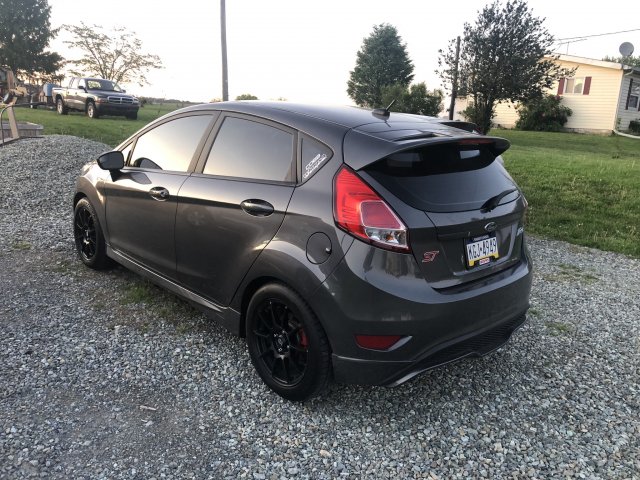

So here is how she sat when I picked her up about 2 months ago from the dealer. 2018 base model (no recaros:cry:) magnetic with 38k on the odometer IMG_4545.JPEG IMG_4544.JPEG
The first thing I did to it, as soon as I got it home, was delete the front plate (I live in PA, so it's not needed and I hate the look lol). The next day my AP showed up (thanks to a member on here), so it got a stage 1 tune.

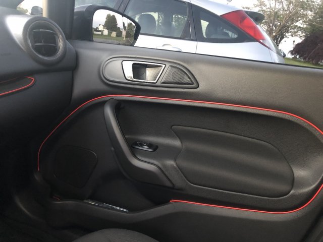

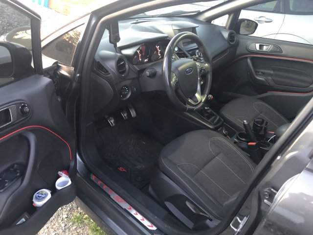

since then, I've been doing lots of small things to it. Inside, ST shift knob, rubber floor mats, full LED interior lights, and some gap trim (don't @ me). I also sent all the "chrome" bits (door handles, steering wheel trim, and vent trims) out to be hydrodipped. they turned out ok, I would've liked a more black carbon fiber look over the gray look, but it's better than the silver (which I couldn't stand) so I'm ok with it. I also painted the trim around the gauge cluster and around the cupholder. IMG_4836.JPEG IMG_4837.JPEG IMG_4838.JPEG

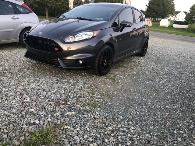

on the outside, I did an 18% tint all the way around, with a 5% brow. Added a shorter antenna, and a lamin-x rear bumper guard. wheels are sparco 16x7, tires are continental DWS 03's in 205x50rz16. Oh, and of corse the decals for the +/- 5HP IMG_4834.JPEG IMG_4835.JPEG

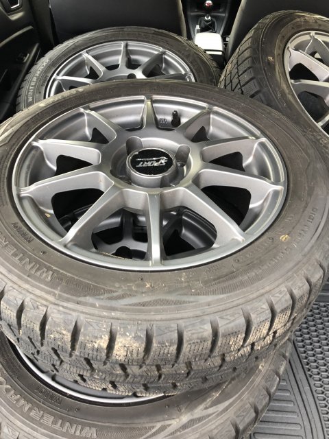

I also picked up some 15" rims with snow tires off of facebook as well. the plan is have the sparcos as my 3 season setup, and to just change out for the winter months when it might snow (mid December-easter). might keep them as is, might plasti-dip them, idk yet. IMG_4637.JPEG IMG_4638.JPEG

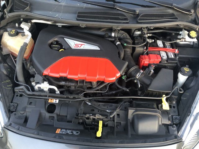

And, finally, under the hood. Only thing I've done mechanically is a turbosmart dual-port BOV (vacuum operated). also did some painting, cause it's not expensive and it gives me something to do lol IMG_4841.JPEG

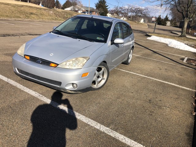

It was the first car I ever actually bought. 03 with a K&N CAI, Magnaflow catback, and for some reason the previous owner lowered just the front of the car (I assume maybe so he could put weight in the back, I know he had a sub, tho I had a 2x12 cabinet and amp in the back and it still sat way high in the back so IDK). WHile the Fist is much more fun, I f4reaking loved that car.
it blew up at about 130k, very sad, and I went and bought my fusion I had for a few years. My dad bought it off of me and rebuilt it. this picture was taken early this year now that it back up and running. I think he's selling it now, so if anyone in PA and looking for one.....

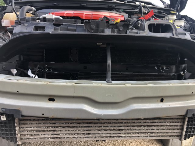

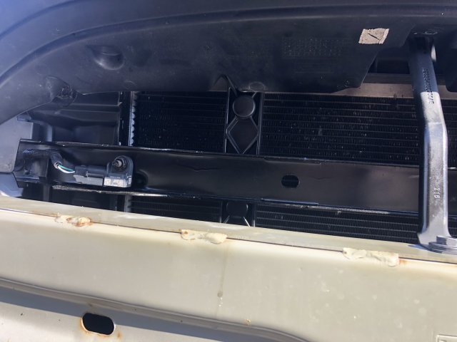

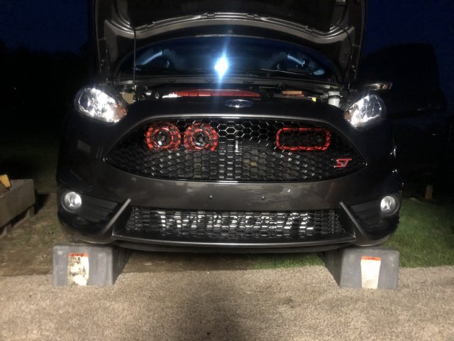

so I started by removing the front bumper, and painting that silver brace that goes in front of the radiator. I know, it's a nitpicky thing, but I just hated it every time I saw it. put some black engine enamel on it, and looks so much better! took like 5 minutes and 1/4 of a can of spray paint, too. (FYI, yes, I disconnected the battery before removing the airbag sensors) IMG_4890.JPEG

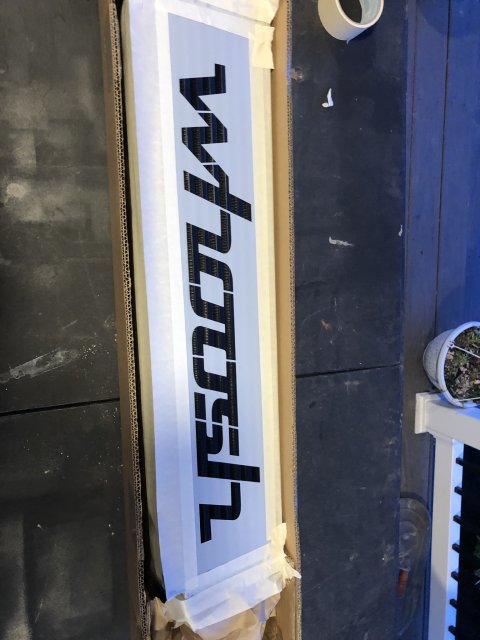

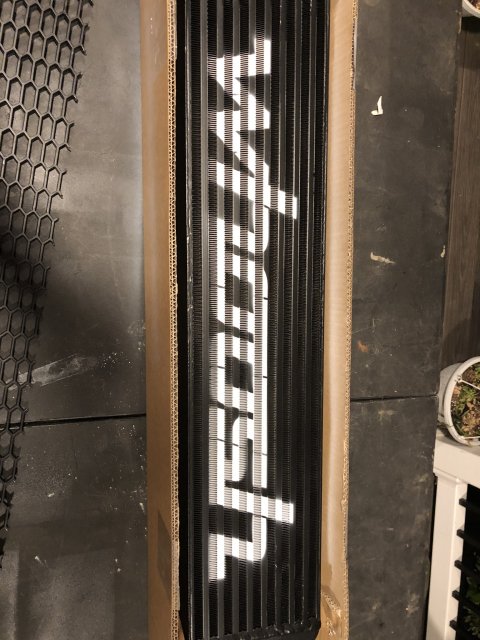

Unfortunately, I forgot to take many progress pics. but I painted the whoosh stencil on the V3 I got from Ron's flash sale the other week. Not quite as good as the V1's that he does, but not bad for my first try. I asked Ron, and he said he uses just regular engine enamel. So just an FYI

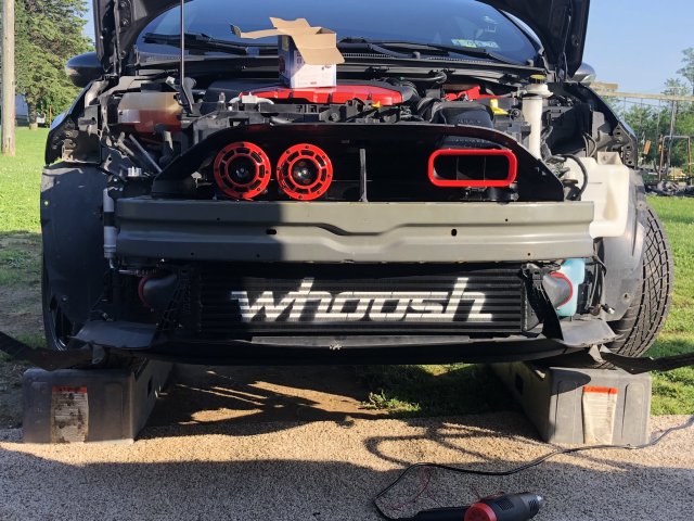

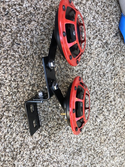

next, was a pair of Hella horns. I put a big mouth on it as well, so my goal with the hella horns was to have them on to the opposite side of the grill from the big mouth. We sell some hardware where I work, so I just grabbed a bunch of brackets and such and whatever it didn't need, I put back on the shelf. this is what I ended up with:
I decided to mount them on said bar I painted earlier. there is a hole in just the right spot, you can see it to the left of the airbag sensor:
I wired them in parallel using the stock wires (just extending them through the crash bar)
next, and I forgot to take pictures of this so please forgive me, I got a full charge hose kit from whoosh, as well as 2 sets of clamps. I did all the hoses but the symposer (I will delete that at a later date). I was able to double clamp all of them except for the turbo outlet itself. I couldn't fit 2 on there, so I just made sure it was good and tight (as I did for all of them). I also did the hairspray method that @TyphoonFiST has recommended on many occasions. Had no issues getting the hoses on at all.
Then I mounted the intercooler itself. It's tight, but it went on decently easy. I did have to take that plastic air dam off that sits above it. the center clip on the bottom of it still doesn't pop forward as it's hitting the back of the intercooler (the tab that the bottom bumper fascia screws to, there are 3 of them and the center one is directly below the intercooler. IDK if most people just cut them or what, but even with it not perfectly in place I was able to screw the fascia to it, so I let it go.
mounted the big mouth (that locknut is a pain in the ass to get up in there, and even once I did I could barely get a wrench on it) and here is what it looks like:

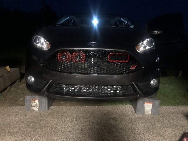

pretty happy with how it turned out.
finally, I cut some plastic XXL diamond grill material from customcargrills.com and mounted it (also cut the supports for the stock grill to give it a cleaner look) I'm happy with the result:
looks much better, and hopefully will help keep rocks away. ran it a bit, and everything looked a-ok, so I flashed cobb stage 2. So far so good! Intake temps are barely going over +15 degrees ambient, when stage 1 it was getting to +30-40 depending on temperature.
