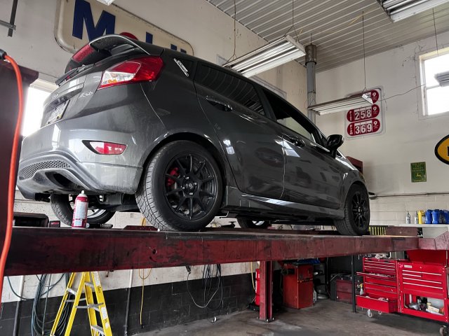

ok, so I got it aligned this week (the local shop was out 2.5 weeks). was still perfect, except for my driver's side was toe'd in pretty bad for some reason (never had it aligned since I bought it this spring, so IDK if it was like that before the Koni's or not). anyway, took care of that and the steering feels wonderful and planted now. Took it on the highway last night, and it is so much better as far as bumps are concerned. didn't feel squirrely at all, even up to 80-85mph.

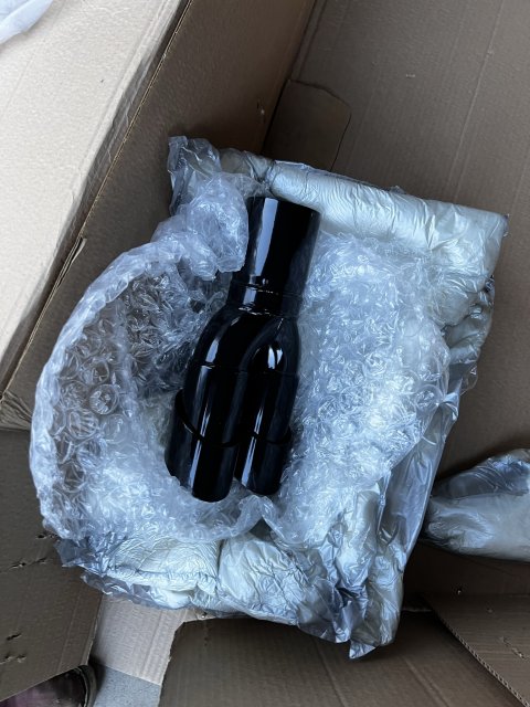

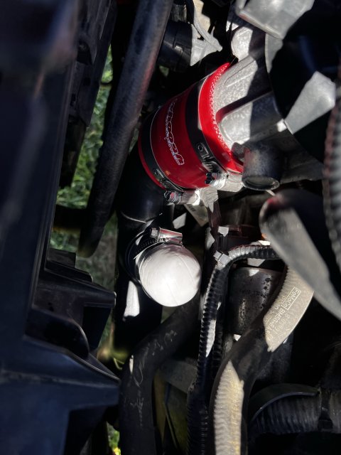

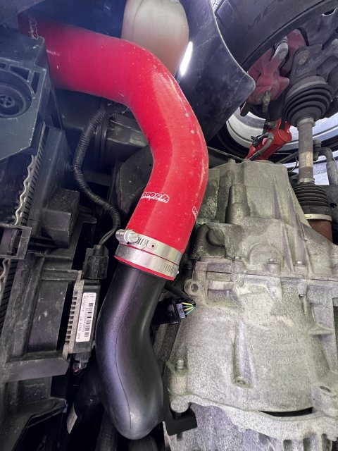

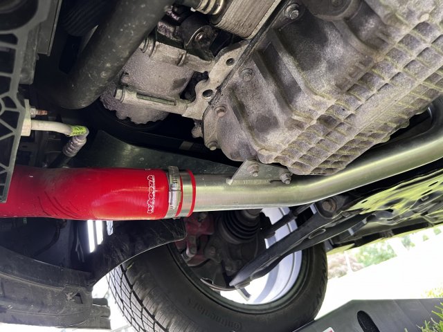

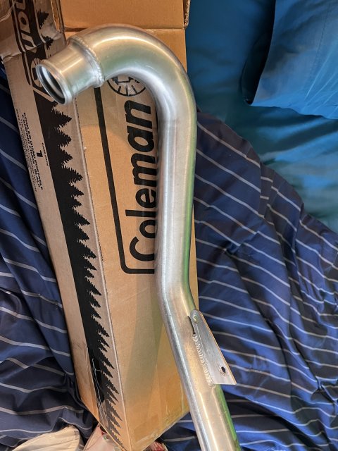

Hope you all had a good weekend! I wasn't planning on doing much this past weekend (haha) as it was supposed to storm all weekend....but it actually didn't storm a ton in my specific area. So, I put on an airtec hot side pipe I picked up from a member on here... IMG_5147.JPEG
its a super nice, solid piece of kit. It's also got the reducer built into the pipe at the turbo side, so you can use the stock rubber hose to the turbo.

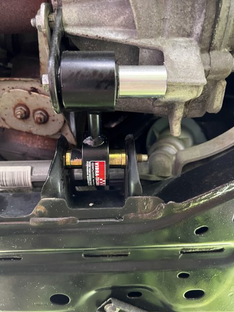

since I kept forgetting, here's a few photos of the other stuff I've done underneath the car:
motor mount has been on a week, and it already feels like it's settled in a good bit (NVH went down, but it's still tight) it's been about 200 miles I'd say

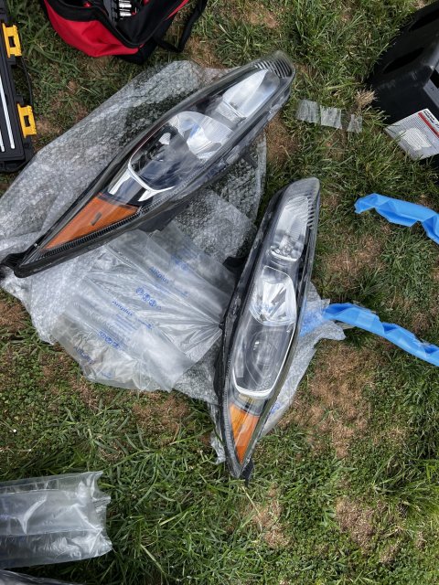

While I was working on the car, UPS brought these:

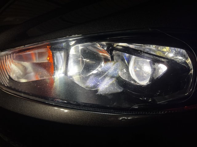

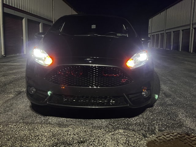

there are the retrofits that @TDavis has had for the past few years. If you haven't followed his build, they are stock lights with projectors fitted in from a corolla. they then have LEDs installed (I believe just the turns signals and projectors, the highs look factory) He upgraded to euro lamps, so I was able to grab them off him. And WOW, what a difference! they look so much nicer on the car, too. I found myself not really needing to use high beams much (at least, not on roads I'm familiar with). I'll probably throw some LED bulbs in the high beams as well, just for the sake of consistency.
I plan on putting lamin-x on them to keep them looking nice ( basically a removable film that goes on the lens) but I haven't decided if I want to go clear, or just an ever-so-slight tint. https://lamin-x.com/ford-fiesta-st-14-19-headlightcovers.html or, I might just darken the ambers a little. IDK yet.

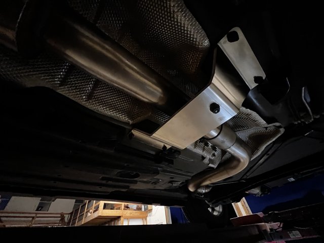

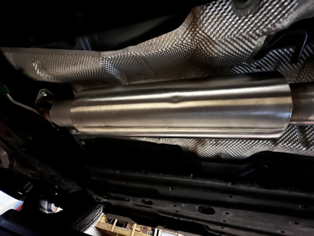

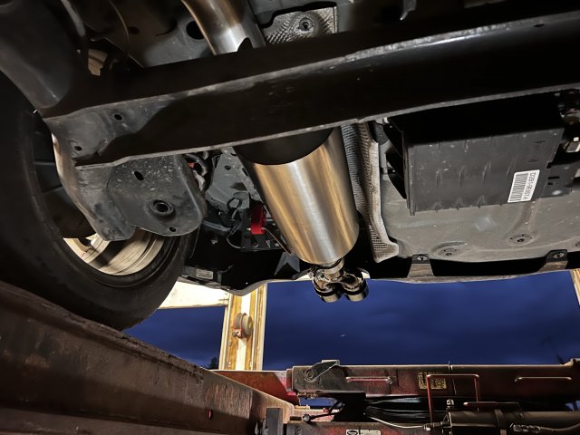

welp, I was going to wait, but long story short last night was the last night I had the chance to use the lift before a month long rebuild project goes on it (not my lift, family friends')

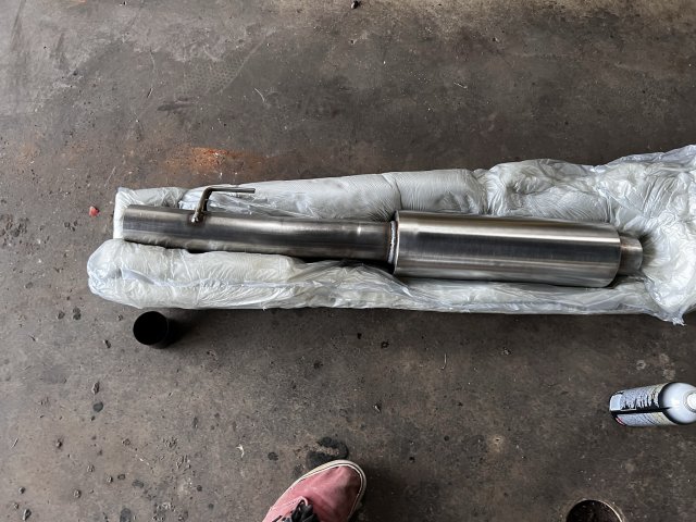

but it just so happens that my Thermal came in yesterday! So I was able to do that last night. wasn't bad, started at 5;30 and was done around 9
Even at only 40k miles, the old exhaust was not the best looking. The studs/nuts that attach the downpipe to the resonator, one stripped and the other snapped at the stud. Sooo, had to get out the cutting torch. It was a PITA, (especially trying to press out the old studs then) but after a lot of heating and cursing, i got them. Luckily I had picked up some bolts and nuts just in case.
the exhaust itself went on very nicely. I made sure to wipe it down, as there was a goot amount of oil and grime on it. overall I'm super happy with it! Quality piece of kit.

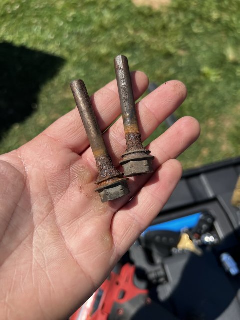

went on vacation all last week, but before I decided to check on a few things. I had suspected that on of my rear calipers were sticking, so I pulled it off, and sure enough:
bone dry and real nasty looking. The dealer that I bought the car from in February (and about 5k miles ago) out all new pads and rotors on, but I guess didn't grease the slide pins (boots were fine and not torn) so I got new pins for both rears and put them on, with some hi-temp grease. I got new pins for the fronts as well, but they've been fine so I'll put them on here sometime before winter.

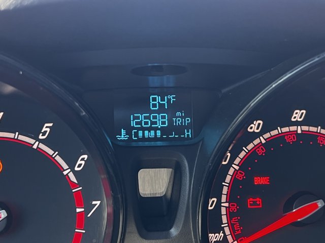

first road trip in the FiST! went down to Wilmington NC to visit friends and go to a wedding (didn't see any other FiSTs, unfortunately :confused: ). Had a great time! 1269 miles total (nice) (including driving around down there). No issues at all, felt great on the highways, and the drive would've SUCKED if I still had the factory dampers. (NC highways down there were not very smooth lol)

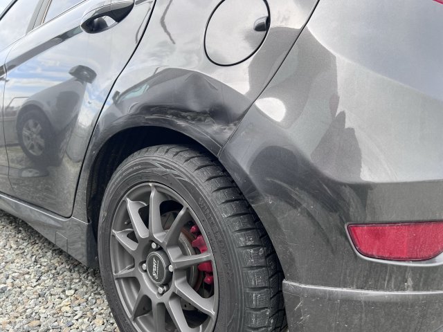

Oh, and this happened:mad: IMG_6205.jpeg
Some lady backed into me in the parking lot of the grocery store about a month and a half ago....had no insurance of course....after fighting my insurance and everything the past month and a half I've given up and I'm just going through the collision of my insurance. I'll have to pay my deductible which sucks, but luckily isn't too much. I'm just more upset that someone doing something so blatantly illegal (no insurance) won't be held accountable for anything. that's scheduled for 2 weeks from now.

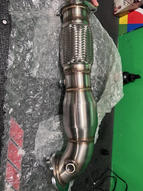

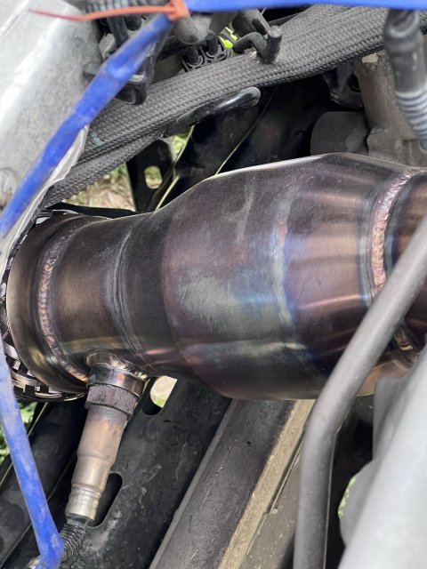

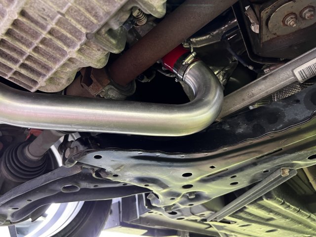

Pretty productive week! got my whoosh catted DP installed that I bought back last fall: IMG_6316.jpeg IMG_6333.JPEG And yes, I paid a shop to do it, it pains me (as I usually do everything myself other than allignments) but the lift I used for my exhaust was being used and I just didn't feel like trying it on stands....

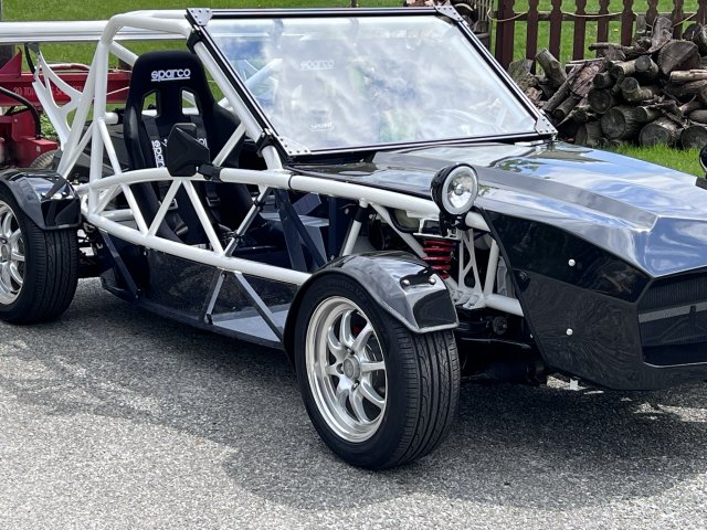

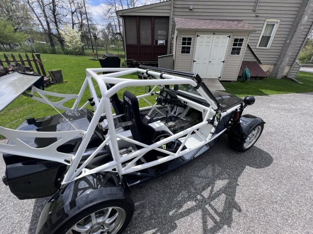

Anyway, picked up my car at my local shop and saw this next to it... IMG_6320.JPEG IMG_6319.JPEG
pretty cool, I've never seen an Exocet in person, but I think it would be a TON of fun to build one...

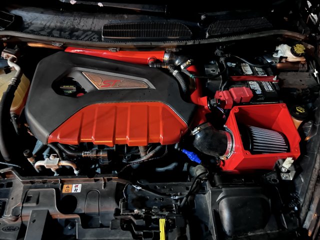

Then Saturday was intake day. Installed a CPE intake with a dry filter:
(minus the plexiglass cover cause the screws blew away, will get new ones)
Took a while to do, but I'm happy with the fitment. It does fit very snugly in the engine bay tho, not much room for movement. I put some foam on the AC lines back by the turbo, as I saw some people have the intake rub through them. I'm gonna wait to see if it starts rubbing anywhere else and I'll add padding as needed.
I also swapped over to the 14-15' evap harness (I've had a purge valve code and stuttering on fill-up for a month or 2 now). had to sand the finish off of the bung on the intake a little, but good fitment other than that.

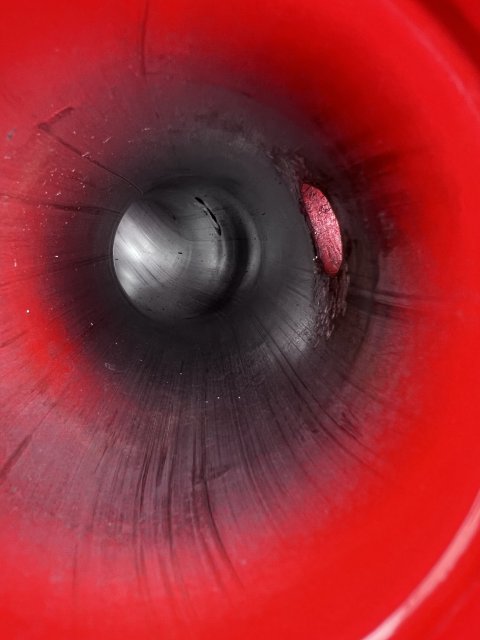

Just a PSA: check your intake tubes from the factory! I had some bits of millings that luckily I saw before I installed is and was able to clean them out

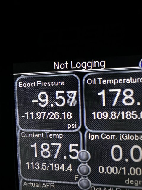

With the intake on and DP on, I loaded up my first MAP from Adam at tune+ (been running Cobb stage 1/2 since I got the car) and did my first datalogs after running it a day or it. Geez, 26PSI max boost! car definitely "woke up".

Exocet is what I'm building next once my Fiesta goes boom.
that's my plan as well (well, considering the FiST is my daily, would be in addition to the FiST) when/if I ever have a proper shop space to build one.....
