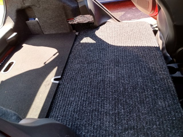

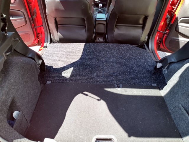

After removing the rear seats there was a surprising amount of noise from the back. I used a sticky back foam/aluminum duct insulation, instead of costly dynamat to quiet it down. There's still more of noise than before from further back. I think the rear seats absorbed a lot of noise when in the up position. For a floor where the seats once resided, I bolted and zip tied a MDF panel. I tossed a cheap floor mat on top. This part of the floor angles down slightly towards the front. MDF was chosen for it's flexibility to accommodate the natural curvature.

The insulation I used on the floor did quiet things down some. What you've said makes sense, I'm definitely hearing tire/wheel/brake related noise. I also wonder if the hatch itself is part of the issue.
