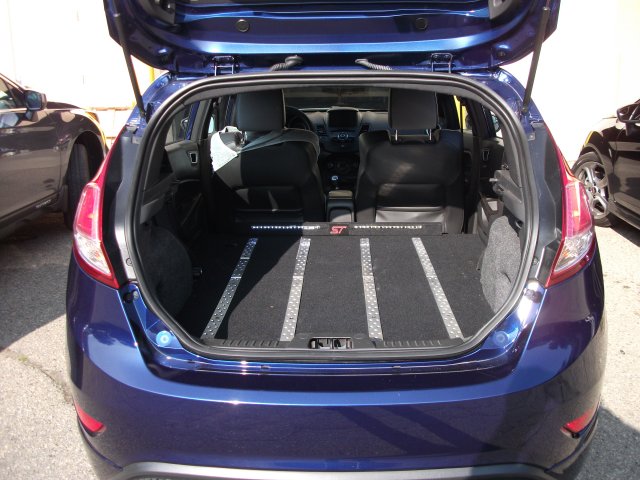

Anyone install a single flat panel closeout to cover up the whole rear seat and trunk area?
I made one. The frame is of thinwall aluminum extrusion tube. The mild steel standoff brackets are attached to the floorpan at the seat attachment bolt pointsThe floor is 1/8 underlayment with automotive carpet on four removable panels.the largest panel is over the spare rim stowage.
The dead space is populated with a storage bin on the forward left side. The forward right side holds a high volume 12v Superflow air compressor and hose. I also added a 12v PowerPoint and 1.5 amp USB to the floor at about Midway on the left side of the cargo floor. There are also four cargo tiedown hardpoints in it that are not visible in the image. I don't think that a single panel design would be a good idea. Multiple panels allow more convenient access.
That is sweet [thumb], but since I still run a factory steel wheel spare and jack in the well, I want to save even the little bit of weight something like that adds back into the mass. [wink]

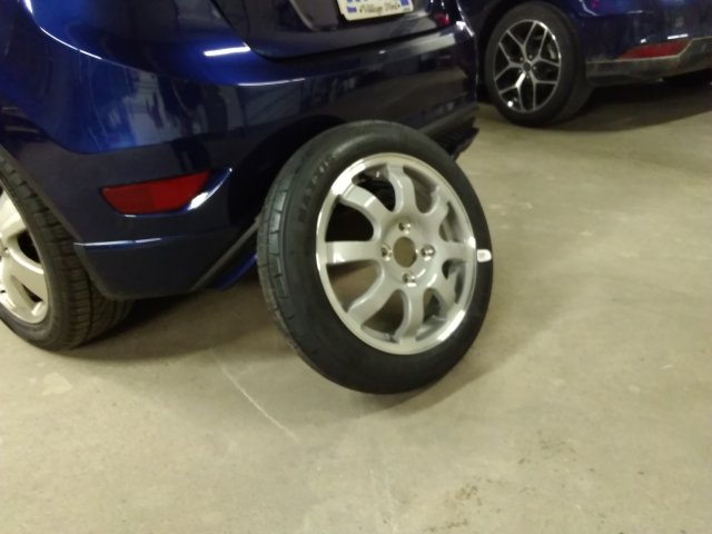

You might want to grab one of these. I believe that this temp spare is what Fiesta SFE pkg sedans got as part of the option spec. It is feather light compared to what the ST got.
I think I paid Twenty bucks for it at a junkyard.
