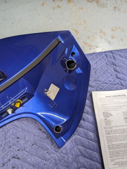

Wing before any repair:
Cut off the square ends off the ABS cleanout plugs, keeping them as long as possible.

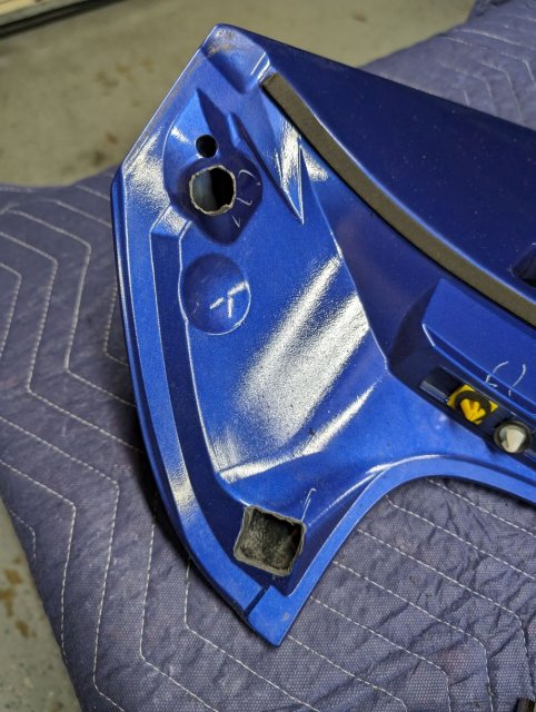

Use a Dremel cutoff wheel to cut a square hole in the wing where the broken screw mounts are (refer to photos for proper orientation). Make sure to cut the hole smaller than the ABS cleanout plug.

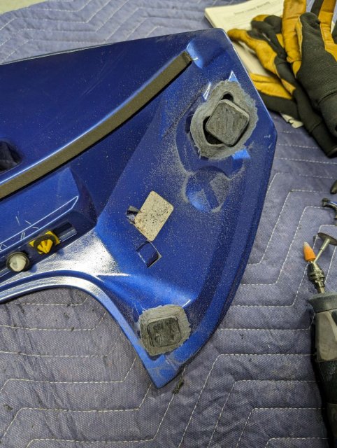

Carefully use the Dremel grinding stone to shape the hole until it is a press-fit for the ABS cleanout plug, then press in the ABS plug. You will need to trim/shape the cut end of the ABS plug that is inside the wing until it sits flush with the top of the old mounting hole in the wing. This will require you to remove the plug, trim the back of the plug, rinse, and repeat several times. It may help to drill a small hole in the ABS plug and put a screw into it to make removal/insertion easier.
Now use the grinding stone to remove the paint on the wing around the ABS plug to create a ~½” border. Also lightly grind the exposed end of the ABS plug. This will help the PlasticWeld epoxy bond better and create a stronger mount.
Repeat the previous 2 steps for each broken mount.

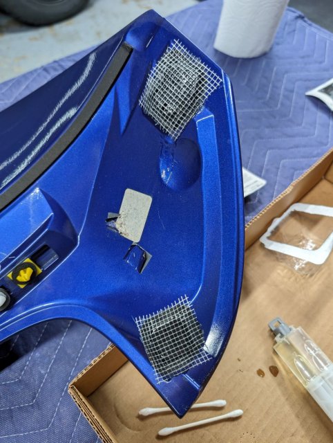

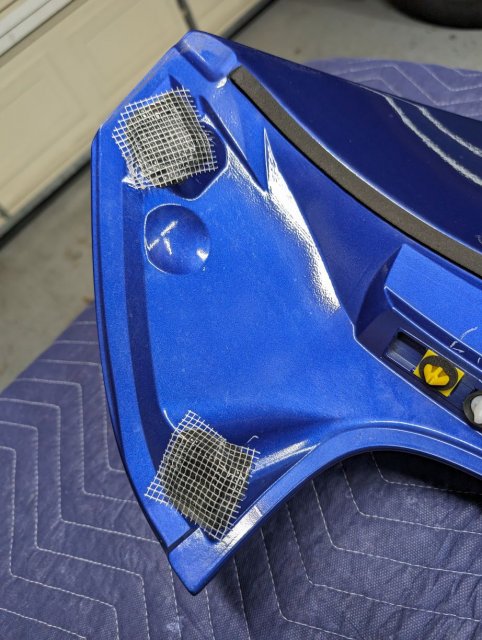

Cut a piece of FibaTape and place over all the exposed ABS surface, overlapping the painted area of the wing slightly (you can trim later). Press the tape down firmly to match the contour of the repaired area. This tape will provide reinforcement for the epoxy, creating a stronger mount.
Squeeze out a small amount of PlasticWeld epoxy into the supplied container (it tacks up fast, don’t bite off more than you can chew), mix up the epoxy according to the instructions, and dab it onto the repair area. Less is more and the epoxy will run if you apply too much. The FibaTape might lift off the repair surface slightly, but once the epoxy tacks up enough you can use a toothpick to press the FibaTape back down.
Wait an hour between coats of epoxy. I ended up using about ⅔ of the tube of PlasticWeld for 3 or 4 coats of epoxy. PlasticWeld says full cure time is 1 hour, but in my cold garage it was still slightly tacky the next morning, so I brought it inside and gave it a couple days since I wasn’t in a rush and it was raining. I would allow at least 24 hours at 70 degrees for peace of mind.
