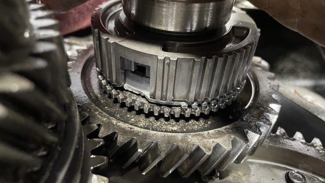

Hey guys new here. Recently my reverse synchro gave out and I’ve been having trouble finding parts. Called a couple ford dealerships around my area to find out that they are back ordered. Also someone told me 5&6 gear synchro works for the reverse gear, but that doesn’t seem right to me. If anyone know where I can buy the synchro set for my reverse idler gear And reverse bearing. Or if the 5&6 gear synchro would work. (2015 fiesta st 1.6l turbo. 6 speed transmission)

Reverse gears on a manual are dog not synchromesh, as far as I recall.
And yea, you might as well go with aftermarket parts while you have it open. Assuming it's in the budget.
