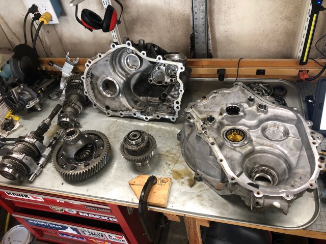

Greetings folks. I recently completed the rebuild of the transmission in my FiST after it developed a whining noise. I had noticed the noise, along with a sort of rattle, growing stronger over the months leading up to it getting really bad. The noise was there but it was quiet. I took the car to PittRace with the local Porsche Club / Audi Club for an HPDE back in May. On day three of the event, the noise had grown so loud that I skipped the last couple sessions in favor of hoping to get home. (I live in the DC area) Thankfully I made it home and decided that I would give it a go myself. I have the means; a garage, second vehicle, so I figured what could be the worst that could happen? (failure, need to replace the trans again) - So let's give it a shot. I started doing the research, making lists, etc. Had some friends assist with the removal. (followed along with the OEM shop manual) Breaking apart the trans didn't reveal any "ah-ha!" issues. (bummer) so I gave it my best shot by replacing the bearings I most thought to be suspect. Put the trans back in and, voila - the issue was still there. ( /facepalm ) I decided to pull it back out (didn't have to remove the subframe!) and replace the rest of the bearings, including those on the input/output shaft themselves (those needle bearings on the shaft. had to replace a few gears.)
Well, this time it worked. Was quite a journey. After a couple weeks I took the car to VIR last weekend for a season-ending HPDE with the Audi club. It was fantastic. The car drives and performs nearly the same as it did before, when things were normal. As someone who's never done any transmission work, it was quite pleasing. Anyway, for anyone who's interested, I did a writeup on my blog, here:
http://blog.sluggyjunx.com/rebuilding-the-transmission-in-my-2014-ford-fiesta-st/
If you have any questions, comments, ideas, etc. please toss them my way. I don't get on these forums as much as I'd like (no access during the day) but I'm around. Feel free to message me. Good luck!

Some interesting things in that manual.
The Ford Racing LSD Installation manual does not mention throwing away the case bolts. It also doesn't mention the torque angle on the bolts. It just says 32NM.
Without this manual you will not know to remove the 2nd and 3rd gear assembly. That snap ring between the syncro hub and second gear is $75 for a fucking snap ring. Thanks Ford. However with a 50ton press the whole gear stack will come off with enough force. HAHA. It will spline that snap ring in the process. Ask me how I know. (You won't destroy that 2nd gear though, lol)
Seriously I was hiding behind a piece of plywood when pressing the output shaft apart. The noises that damn output shaft makes when you are pressing it apart is scary. It will sound like a gun goes of when those gears move. Stupid Ford. Spline the damn gears like everyone else on the planet.
I didn't find the yellow Loctite on that left hand socket head bolt that bad. A little heat and it came right out with a 3/8s ratchet.
Brett - sorry to take so long to reply - I can't access the forums during the day and I forget to hop on in the evenings. As for the snap rings, yeah - it blew my mind how expensive it is. The odd thing, to me, is that other snap rings in the same vicinity and of what seems like similar materials are only a few bucks. It's like someone missed a decimal point somewhere and it's never been corrected. Frustrating. I decided not to replace that snap ring, as it was in good condition on removal and re-installation.
Hiding behind plywood - yes! HA! When I took it to a shop the guy doing it was turned away with his oxy-acetylene torch in hand. The second it popped, he turned to me and said, "here! hold this!" and handed me the torch. I was a bit bewildered, but so excited the damn thing broke loose. And yes, you're correct - 50 ton press is required! We tried with my 12 ton. Tried again with my buddy's 25 ton. NOPE! The 50 ton seemed to barely do it. Took a lot of heat to get it to pop. And, yes, FORD: please spline the damn gears in the future! The input shaft took me like 30 min to rebuild!
As for the yellow Loctite - you are correct. Not so bad! BUT - it was bad for me b/c I forgot it was reverse thread and broke a bit in the process. HA! Went and got some impact hex socket and it was no prob with a big ugga-dugga impact gun. Got to have the right tool for the job here. Makes ALL the difference.
