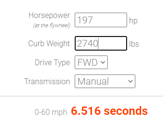

Like I said before, I haven't had the opportunity or inclination to test it side by side, but you have piqued my interest, so I turned to one of those online 0-60 calculators.
If you enter in stock figures, you get this:
Which is a little faster than what many sources claim the stock 0-60 is.

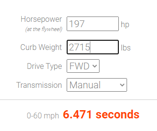

As discussed before, the spare and jack weigh about 40 lbs, but lets go with the 25 pounds you suggested, Egg:
Sure, this is just a blast from 0-60 (and a modeled one at at that), but lighter weight helps in all aspects of of performance- braking and turning as well as acceleration.
Some people would say that 45 thousandths of a second is minimal, but I have been in numerous autocross events where the gaps were even smaller.
I think you can get too obsessive about weight savings, but losing 25 or 40 pounds would have real world effects.

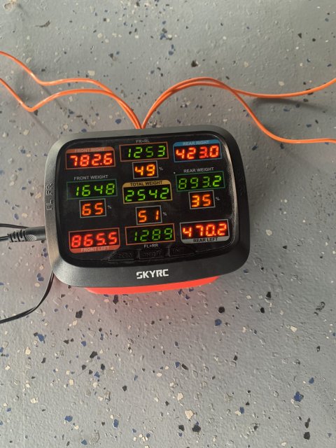

This is without wheels on the car (16x8 Dekagrams and 205/45 RS-Pros), half a tank and no back seat, belts, brackets, speakers, spare, wiper, washer res etc. All other interior plastics though. Should be around 2,680 with wheels. You do feel the weight loss when it comes to acceleration and autocross. The car probably makes like 220whp it needs all the help it can get lol

I know that thing... Isn't that a RC scale?
