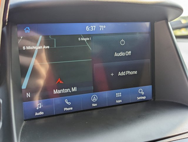

Example of what this updated version of Sync looks like now on the home screen:

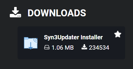

First, get on your PC and navigate to this page on Cyanlabs' site: https://cyanlabs.net/tutorials/sync-3-automated-method-update-to-3-4/
Scroll down to this, and click "Get Syn3 Updater", and download it at the following page.

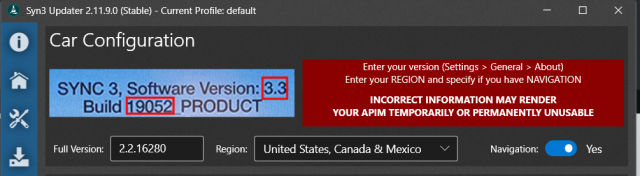

Run it, and go through its install steps allowing it to become installed. Run the software, and head to the settings menu so that you can enter the information for your current Sync setup in your car.
Hop in your car, and put it on accessory so you the radio turns on. Go to its settings, and go to information about Sync so you can see the currently-installed version. My car had Software Version 2.2 and Build 16280. You combine these into one thing (as shown above; 2.2.16280). When you click the menu to type it in, it should display a list of versions, so you can select the version instead of typing it to avoid errors typing it. Triple-check it matches your car; it needs to match so that this process works correctly. Then select your region, and choose if you have Navigation or not.

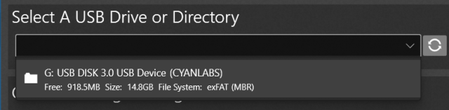

Select your chosen drive. Performing this process is going to wipe your drive, so ensure if you have any information on it that you move it elsewhere first.

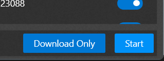

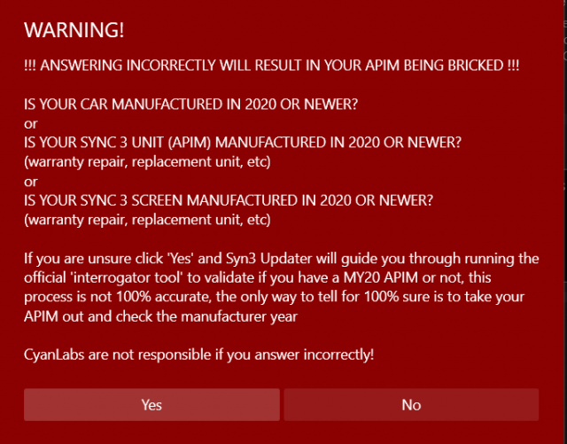

Choose "Start". You will be hit with a big red prompt informing you that you MUST answer correctly if you have a 2020+ unit. Obviously, we are Mk7 Fiesta owners so none of our cars are 2020+. Select "No" (or whatever option clarifies you do NOT have a 2020+ car, if this prompt changes in future software versions of Syn3Updater). It will start downloading all the information, then apply it to the drive. This will take a while (15-45 minutes, or longer with slower internet), so go find something to do.

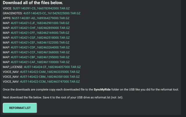

I'm on a Mac without access to a PC so I had to do the manual method. The video embedded on the manual method page was useful, but glossed over some specifics that led me to a couple false starts and one small panic attack where I thought I bricked my APIM. For anyone else on macOS I have a couple tips:
- Make sure the file names you save on your USB stick match exactly to your generated file names, extension included. The file names generated for mine are below. Mine downloaded and saved like this for example: 5U5T-14G391-CS.tar. Once I manually updated the file names to match the below exactly, i.e. 5U5T-14G391-CS_1660783942000.TAR.GZ, it worked.
- At first I transferred all the downloaded files (with correct file names) to my USB at the same time. For whatever reason this still resulted in a failed installation for me so I downloaded them, updated the file name, and transferred them one by one. It was a pain in the ass and took longer but wound up working. You might not have the same issues but this method worked for me.

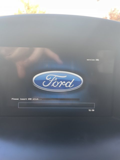

Has anyone gotten to the progress bar with the 3x ford images and screen just reads, “Please insert USB stick”? I did not remove the USB as the system was rebooting so I am unsure if the update has started or not.
