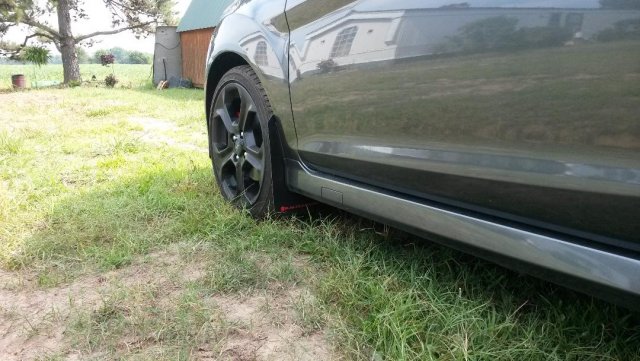

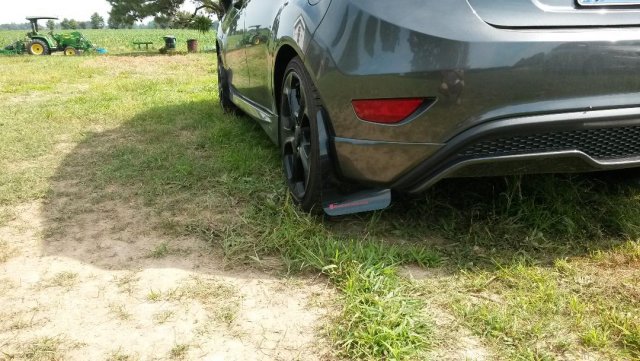

So the bottom line here is you have to have some ingenuity to make it look decent enough. I've only done one side and I'm happy with the results. It doesn't look perfect but most people probably would not notice. Plus I've read that even with the full-price custom fit RA flaps there is some gap, so even spending big money doesn't make it look perfect.
The deal here is I wanted flaps that didn't stick far out the side of the car like the ones made for our car. Unfortunately in order to keep this from happening and for it to look uniform both front and back (height from ground) I had to pull the back flap in toward the center of the car a bit; otherwise it would have shown that harsh angle like the custom RA flaps for our cars to, which I did not want. Still I'm liking it, the back tires have the oversized look now which is cool, and again most people would never even notice.
If you're doing this it's vital to fit both front and back before attaching as the way you do one will depend on how you did the other, if you want consistency of appearance that is.

Pictures don't do it justice, it really does look pretty good in person. I have pretty high standards and I'm happy with it. I might go back later and work with the front more to reduce the gap a bit more, for now I'm tired! I'll post more pics once I get the other side done probably in a week or so.....
OK go spend your money on the full deal for $160 or save a bit of money and get a more subtle look like I did, I can see both being good options. Thanks for reading!

Yes these look much better than the RALLY ones made for the ST nice work very subtle!!!

Actually very nice looking. What bothered me about the RA ones is they they stick out much.
