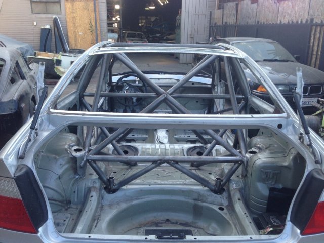

Heres an example:
E46 M3
e52pavlav1.jpg 4130 chromoly tubing. All junctions are TIG welded and tied to the chassis at structural points.
Price: starting at $6k
Like I said.....roll cage for $3k?........run!!!!

Heres an example:
E46 M3
View attachment 38635 4130 chromoly tubing. All junctions are TIG welded and tied to the chassis at structural points.
Yea lol. A custom 4 point DOM bar for my car would cost at least $3500, assuming I pull and reinstall the interior myself. It takes a long time to build these things from bar stock. Chromo stock is way more expensive and can be more costly to weld.
