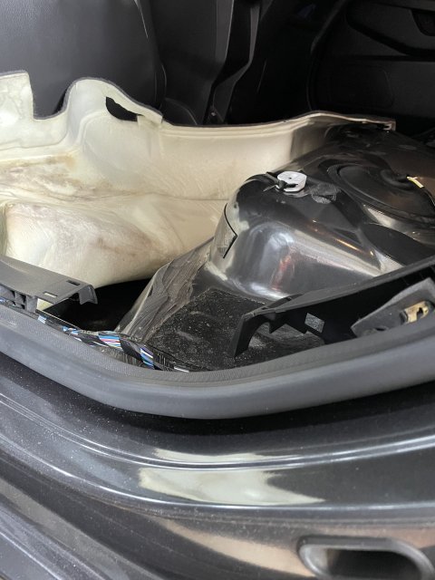

I know this is an old thread, bare with me here. I fixed the water leak in the wheel well of the trunk in my 17 FiST, now I have a major water pooling issue under the passenger footwell. Carpet is soaked. This one I cannot locate.
Check the front passenger door seal at the bottom. Mines leaking there. I just stuff a towel in between the seat and the side of the car
