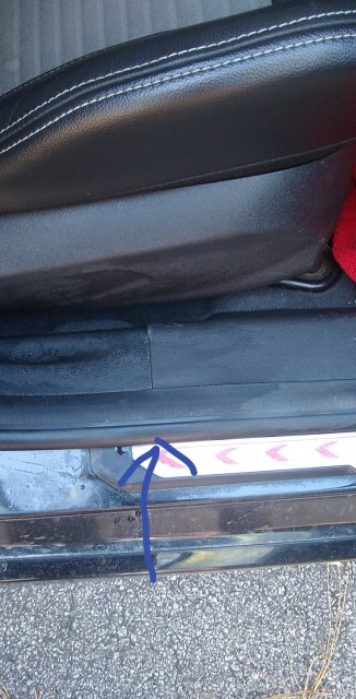

This is where the water get in on mine. I still don't have a solution other than a towel to soak up the water and a car cover when I'm parked. It's annoying because I don't want any rust to start forming. I've thought about pulling out the carpet so I could monitor it.

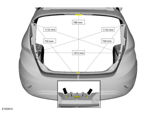

I had a similar leak. The hatch itself was not quite tight enough when latched. I moved the latchpoint inward a few mm (takes a torqx bit) and the leaking has stopped. e163814_eur_580.jpg
